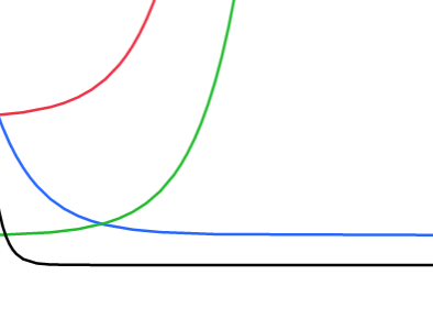

Exponential 2P
Image shown here
Equation shown here
a = Scale
b = Growth Rate
Exponential 3P
Image shown here
Equation shown here
a = Asymptote
b = Scale
c = Growth Rate

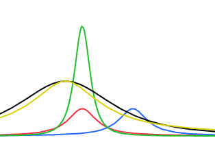

Pseudo-Voigt Peak
Image shown here
Equation shown here
d = Mixing Parameter
l(x) = evaluation of Lorentzian Peak function
g(x) = evaluation of Gaussian Peak function
Available only when the response values are nonnegative.
Pearson VII Peak
Image shown here
Equation shown here
a = Location
b = Scale
c = Shape
d = Peak Value
Lorentzian Peak
Image shown here
Equation shown here
a = Peak Value
b = Growth Rate
c = Critical Point

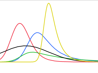

One Compartment Oral Dose
Image shown here
Image shown here
Equation shown here
a = Area Under Curve
b = Elimination Rate
c = Absorption Rate
Available only when the response values and the x values are all positive.

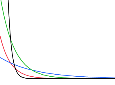

First Order Rate
Image shown here
Equation shown here
a = Initial Value
b = Rate Constant
Available only if the x values are nonnegative.

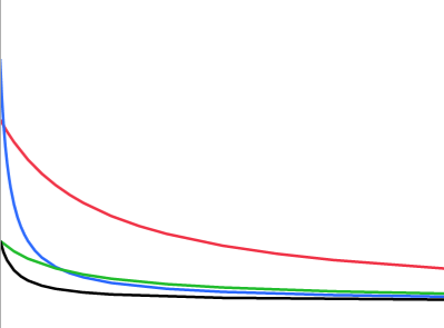

Second Order
Image shown here
Equation shown here
a = Initial Value
b = Rate Constant

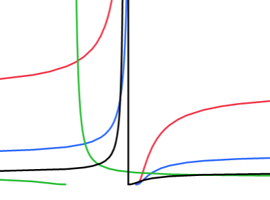

Antoine Equation
Image shown here
Equation shown here
a = Component Specific Constant
b = Component Specific Constant
c = Component Specific Constant
Available only when the response values are greater than 0.
The vertical asymptote is at 10a.
The horizontal asymptote is at c.
