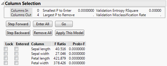

If you select the Stepwise Variable Selection option in the launch window, the Discriminant Analysis report contains a Column Selection panel. You can perform stepwise analysis using the buttons to select variables or selecting them manually with the Lock and Entered check boxes. Based on your selection F ratios and p-values are updated. For more information about how these are updated, see Updating the F Ratio and Prob>F.
If you specify any type of validation set, a Go button appears. When you click Go, JMP uses the validation set statistics to determine how many steps to take.
Figure 5.4 Column Selection Panel for Iris.jmp with a Validation Set
