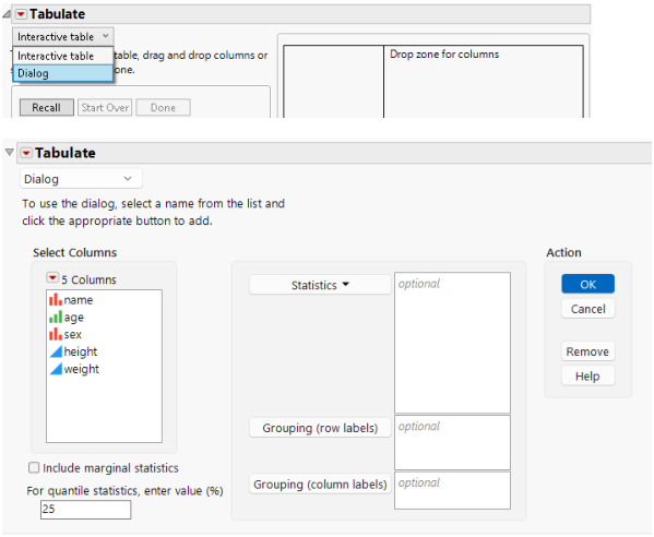

If you prefer not to use drag and drop operations to build a table interactively, you can create a simple table using the Dialog interface in the Tabulate platform. After selecting Analyze > Tabulate, select Dialog from the menu, as shown in Figure 9.8. You can make changes to the table by selecting Show Control Panel from the red triangle menu, and then drag and drop new items into the table.
Figure 9.8 Using the Dialog Interface
