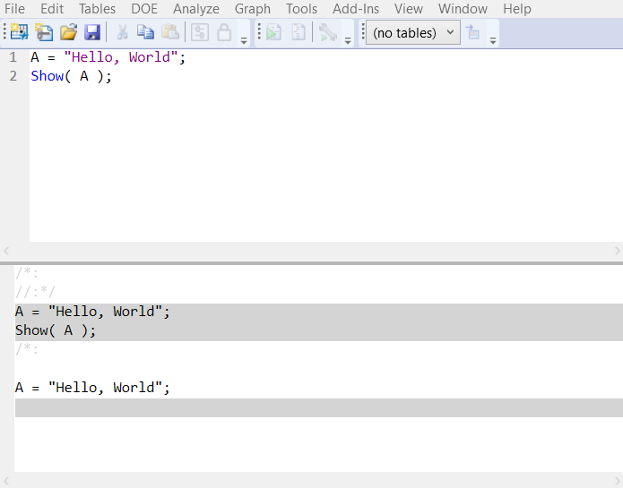

You can view the log inside the script window by right-clicking and selecting Show Embedded Log. To view the embedded log by default, select Show embedded log on script window open in the Script Editor preferences. This option makes it easy to edit and run a script, quickly see the results of your changes, and then continue to develop the script. The embedded log uses the Text log mode. See Text Log in JMP.
The embedded log always appears in the Scripting Index script window, but it is not available in Application Builder and the Debugger.
Figure 4.10 The Script Window with an Embedded Text Log
