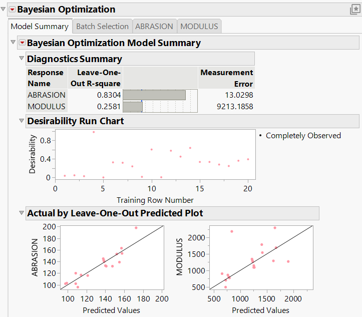

Model Summary Tab
The Model Summary tab contains the Bayesian Optimization Model Summary report. This tab is the default tab shown when a batch is not automatically generated on launch. The Bayesian Optimization Model Summary report provides a summary of the information in the individual response reports that are generated for each response that is specified in the launch window. The report includes model diagnostics, actual by predicted plots, and prediction profilers for all of the responses. In the profilers section, there is a button that enables you to show or hide plots of the response prediction standard deviations. By default, plots for the standard deviations are not shown. For more information about the prediction profiler, see “Profiler” in Profilers.
The Diagnostics Summary table contains the Leave-One-Out RSquare and Measurement Error values for each individual Gaussian Process fit. Models with an RSquare value below the threshold value that is specified in the launch window are highlighted in red. The Measurement Error is calculated as the product of the nugget parameter, τ, and the Gaussian Process variance, σ2.
