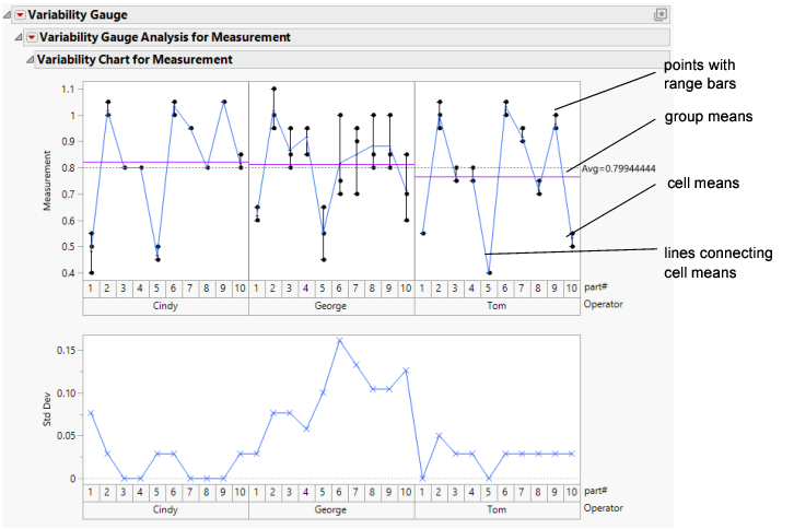

The Variability Gauge report contains a Variability Gauge Analysis report for each response column that was specified in the launch window. By default, there are two charts in each Variability Gauge Analysis report. The measurement variability chart and the standard deviation chart show patterns of variation. You can use these charts to identify possible groups of variation (within subgroups, between subgroups, over time). If you notice that any of these sources of variation are large, you can then work to reduce the variation for that source.
Figure 6.4 Variability Gauge Report
The charts show the response on the y-axis and a multilevel, categorized x-axis.
In Figure 6.4, the Measurement chart shows the range of measurements for each operator by part. Each measurement appears on the chart. Maximum and minimum bars indicate the range of values for each cell, and a cell means bar indicates the mean value for each combination of values. The Std Dev chart plots the standard deviation of the measurements taken on each part by operator.
You can add features to the charts, as illustrated in Figure 6.4. See Variability Gauge Platform Options.
