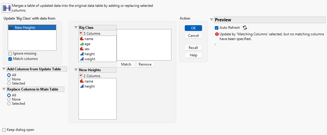

To update a table by using matching columns
1. Follow the first three steps that are outlined in the previous section, To replace values in the active table with those found in another open table.
2. Select Match columns.
3. Highlight the two column names (in the respective tables) that you want to match.
4. Click Match.

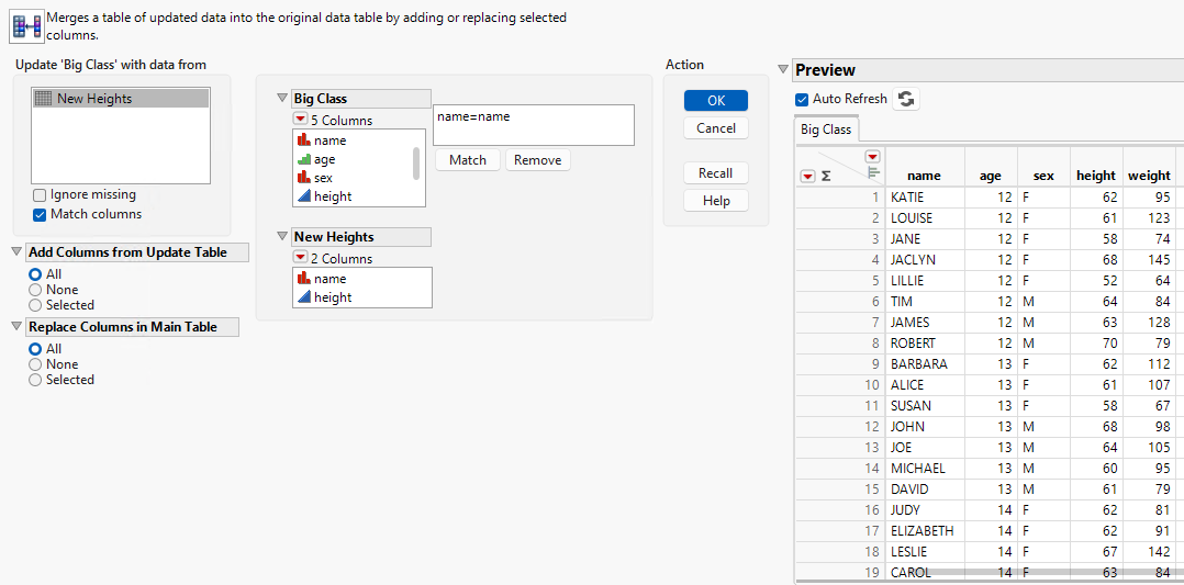

Figure 6.46 Updating a Table with Matching Columns
5. (Optional) Repeat to match more columns.
6. Click OK.
