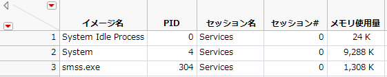

また、cmd.exeを使用せずにプロセス一覧を直接出力させ、データテーブルに読み込むこともできます。
blob = Run Program(
Executable( "tasklist.exe" ),
Read Function( "blob" )
Open(
blob,
Columns(
Column( "Image Name", Character, "Nominal" ),
Column(
"PID",
Numeric,
"Continuous",
Format( "最適", 10 )
Column( "Session Name", Character, "Nominal" ),
Column(
"Session#",
Numeric,
"Continuous",
Format( "最適", 10 )
Column( "Mem Usage", Character, "Nominal" ),
Omitted Column( .)
Import Settings(
Fixed Column Widths( 26, 9, 17, 12, 12, 63 ),
Labels( 1 ),
Column Names Start( 2 ),
Data Starts( 4 )
