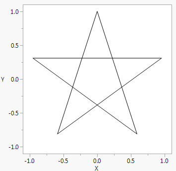

Line()は点の間に線を引きます。
win = New Window( "星",
Graph Box(
Frame Size( 300, 300 ),
X Scale( -1.1, 1.1 ),
Y Scale( -1.1, 1.1 ),
Line(
{Cos( 1 * Pi() / 10 ), Sin( 1 * Pi() / 10 )},
{Cos( 9 * Pi() / 10 ), Sin( 9 * Pi() / 10 )},
{Cos( 17 * Pi() / 10 ), Sin( 17 * Pi() / 10 )},
{Cos( 5 * Pi() / 10 ), Sin( 5 * Pi() / 10 )},
{Cos( 13 * Pi() / 10 ), Sin( 13 * Pi() / 10 )},
図12.10 線を使って星を描く
