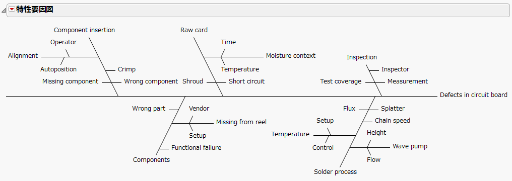

図14.1 特性要因図の例
Example of a Cause-and-Effect Diagram
