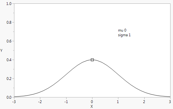

Handle() places a marker at the coordinates given by the initial values of the first two arguments and draws the JMP graph using the initial values of the arguments. You can then click and drag the marker to move the handle to a new location. The first script is executed at each mousedown to update the graph dynamically, according to the new coordinates of the handle. The second script (optional, and not used here) is executed at each mouseup, similarly; see the example for Mousetrap().
// Normal Density
mu = 0;
sigma = 1;
rsqrt2pi = 1 / Sqrt( 2 * Pi() );
win = New Window( "Normal Density",
	Graph Box(
		Frame Size( 500, 300 ),
		X Scale( -3, 3 ),
		Y Scale( 0, 1 ),
		Y Function( Normal Density( (x - mu) / sigma ) / sigma, x );
		Handle(
			mu,
			rsqrt2pi / sigma,
			mu = x;
			sigma = rsqrt2pi / y;
		Text( {1, .7}, "mu ", mu, {1, .65}, "sigma ", sigma );
Run demoPlotProb.jsl in the JMP Samples/Scripts folder to see Beta Density, Gamma Density, Weibull Density, and LogNormal Density graphs. The output for Normal Density is shown in Figure 12.23. Because we cannot show you the picture in motion, be sure to run this script yourself.
Figure 12.23 Normal Density Example for Handle()
To avoid errors, be sure to set the initial values of the handle’s coordinates, as in the first line of this example.

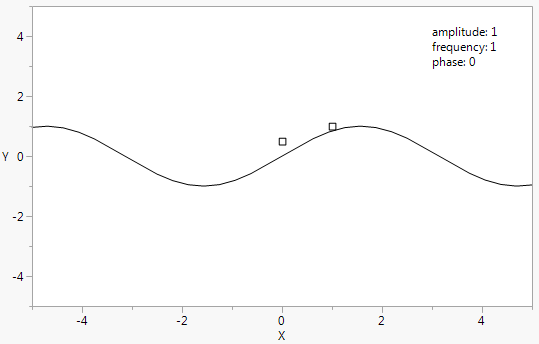

You can use more than one handle in a graph:
amplitude = 1;
freq = 1;
phase = 0;
win = New Window( "Sine Wave",
	Graph Box(
		X Scale( -5, 5 ),
		Y Scale( -5, 5 ),
		Y Function( amplitude * Sine( x / freq + phase ), x );
		Handle( // first handle
			freq,
			amplitude,
			freq = x;
			amplitude = y;
		Handle( phase, .5, phase = x ); // second handle
		Text(
			{3, 4},
			"amplitude: ",
			Round( amplitude, 4 ),
			{3, 3.5},
			"frequency: ",
			Round( freq, 4 ),
			{3, 3},
			"phase: ",
			Round( phase, 4 )
Figure 12.26 Two Handles
