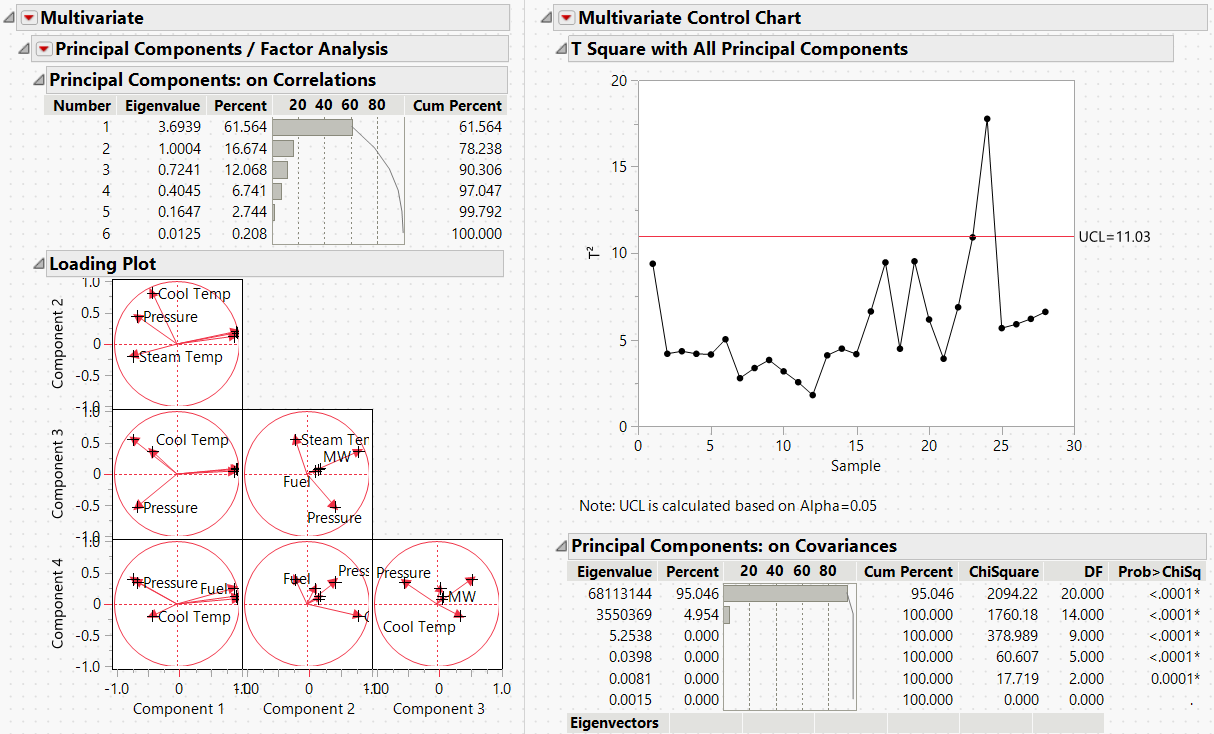

Parameterizing Variables
The following example shows how to create an application with parameterized variables. Users select the variables in a launch window, and then predefined reports are generated.
1. Select Help > Sample Data Folder and open Quality Control/Steam Turbine Historical.jmp.
2. Run the Principal Component Analysis and Loading plot table scripts to generate the reports.
3. Select File > New > Application.
4. Select Blank Application.
The Application Builder window appears.
5. Enlarge the window.
6. In the Sources panel, drag each Multivariate report onto the application workspace in a single row.
7. Select Edit > Select All.
8. Select Format > Add Container > H List Box to align the reports horizontally.
9. Select each report and type yvar next to Y Variable in the Objects panel.
10. Click the Application red triangle and select Run Application.
11. Select the Fuel, Steam Flow, Steam Temp, and MW variables and then click the Y button.
12. Click OK.
New Multivariate reports appear in one window.
Figure 18.12 Multivariate Application

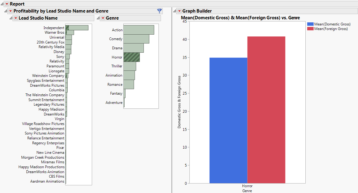

Filtering Data in Multiple Reports
In an application that contains several reports, you can select data in one report and then view only that data in all other reports contained in the same window.
To set up the filter, follow these steps:
1. Create the application and add two reports to the workspace.
2. Select both reports. From the toolbar, select the HListBox icon.
3. Right-click the primary report and select Use as Selection Filter.
This places the primary report display box in a Data Filter Source Box and the parent report display box in a Data Filter Content Box.
4. Click the Application Builder red triangle and select Run Application.
The reports appear in one window (Figure 18.13).
5. Test the application by selecting a histogram bar in the primary report.
Only data for the selected bar appears in the second report.
Figure 18.13 Example of Filtered Content

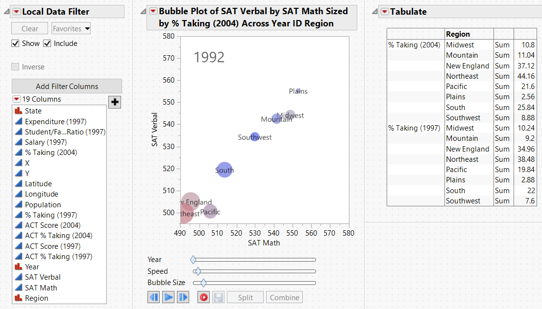

Filtering Data in Separate Reports Using a Local Data Filter
The following example illustrates how to add a Local Data Filter to multiple reports and then filter each report separately.
1. Select Help > Sample Data Folder and open SATByYear.jmp.
2. Run these scripts: Bubble Plot by Region and Graph Builder Map.
3. Resize the report windows to make them smaller, so that a 2x2 arrangement will fit on the screen.

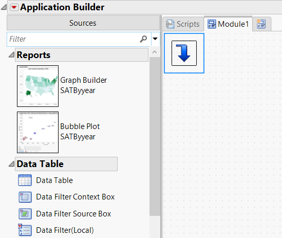

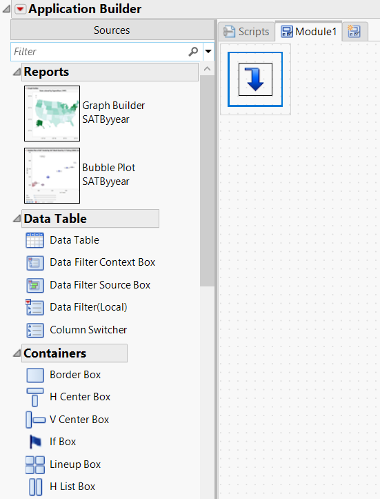

4. Select File > New > Application and choose Blank Application.
5. Double-click Data Filter Context Box.
This adds a data filter context box to the workspace. Everything placed in this box will share the same Local Data Filter.
Figure 18.14 Adding a Data Filter Context Box
6. Under Containers, drag a H List Box into the Data Filter Context Box.
This allows you to put multiple objects in this box and arrange them horizontally.
Figure 18.15 Adding a H List Box
Adding a H List Box
7. Now drag a Data Filter (local), the Bubble Plot, and the Tabulate report into the H List Box.
Figure 18.16 Adding Local Data Filter and Two Reports

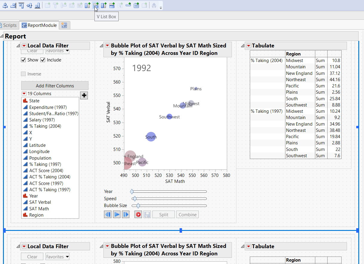

8. Select the entire Data Filter Context Box. Press Ctrl and drag it below itself, to place a copy below the original set of reports.
9. Select both Data Filter Context boxes, then on the toolbar, click the V List Box icon.
This arranges both reports into a single list box for display purposes.
Figure 18.17 Selecting Both Data Filter Context Boxes and the V List Box Icon
10. Click the Application Builder red triangle and select Run Application.
11. In the Local Data Filter on the top, click SAT Math, then click the Add button Image shown here. Move the slider to see how it only impacts the reports at top. Do the same for the bottom set of reports.

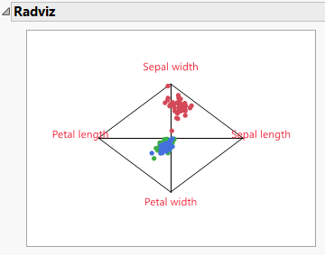

Creating a Launch Window and Report
The Launcher with Report sample application combines a platform launch window with the resulting report. The sample application is displayed when you select File > New > Application.
The following example shows you how to arrange objects and include scripts that make up the application.You will recreate the Launcher with Report sample application so that you can create your own applications similarly.
Note: In the Launcher with Report sample application, the variable names of display boxes are customized to describe the display box. For example, “Text1” was renamed “Description” in the sample application. To reduce the number of steps in this example, you do not rename the variables unless one of the scripts refers to the variable name.
1. Select File > New > Application and click the Launcher with Report sample.
You will copy and paste JSL from this sample into your copy. Notice that the Iris.jmp sample data table opens when you open the application.

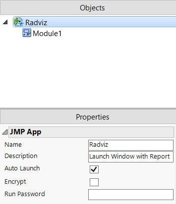

1. In the Objects panel of the blank application, select Application.
2. In the Properties panel:
– Change the Name from Application to “Radviz” and press Enter.
This name appears in the title bar when you run the application.
– Change the Description to “Launch Window with Report”.
Figure 18.19 Customizing the Application

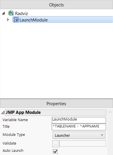

5. In the Objects panel, select Module1.
6. In the Properties panel:
– Change the Variable Name to “LaunchModule” and press Enter.
– Change the Module Type to Launcher.
– Make sure that Auto Launch is selected so that the launch window opens when you run the application.
Figure 18.20 Customizing the LaunchModule

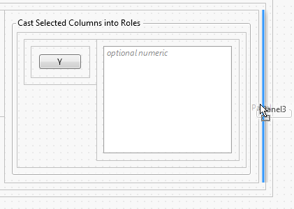

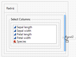

1. Drag a Panel Box (under Containers) to the right of the existing Panel Box until a blue line appears.
Figure 18.22 Adding the Panel Box
Note: Make sure that you drag the Panel Box to the H List Box shown in Figure 18.22.

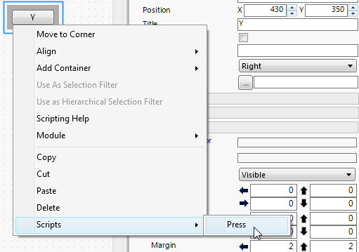

1. Drag a Button Box (under Buttons) over the H List Box arrow.
– Change the Title to “Y” and press Enter.
– In the Press box, type “SetY” and press Enter.
You copy and paste the script for this button later.

Create the Launch Module Script
1. Go back to the Launcher with Report sample application window.
2. Click the Scripts tab.
3. Select LaunchModule as the Namespace and copy the script.
4. Go back to your application window and click the Scripts tab.
5. Delete the script in the LaunchModule namespace and paste the script from the sample application.
6. Select File > Save to save your changes in the.jmpappsource file.

5. Drag an Outline Box (under Containers) to the workspace.
6. In the Properties panel, change the Title to “Radviz” and press Enter.
7. Drag a Graph Box (under Display) over the Outline Box arrow.
8. In the Properties panel, change the Variable Name to “Graph” and press Enter.
9. Select the outer border of the objects on the workspace.
10. Right-click and select Move to Corner.
The extra space around the selected object is removed.
2. Make sure that the Scripts tab is displayed.
3. Select ReportModule as the Namespace and copy the script.
5. Delete the script in the ReportModule namespace and paste the script from the sample application.
Your application should look like the Launcher with Report sample application.

1. In your application window, click the Application Builder red triangle and select Run Application.
2. Select the Sepal length and width and Petal length and width columns, click Y, and then click OK.
A graph of the data should appear.
Figure 18.26 Iris.jmp Graph
Iris.jmp Graph
If the graph does not appear or errors are generated, make sure that you typed in the correct variable names when necessary. Also make sure that you added the scripts to the Scripts tab for each module.

Selecting a script from the Scripts menu adds a placeholder script to the Scripts tab for the selected module. For example, the Press script shown in Figure 18.27 adds the following script to the Scripts tab:
Button5Press=Function({this},
	// This function is called when the button is pressed
	name = this << Get Button Name;
Fill in the placeholder script with your own JSL. In the application that you previously created, you named two variables SetY and ColumnList. Rewrite the preceding placeholder script:
