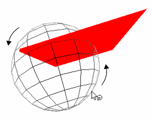

This displays the script with an associated arcball with diameter 2. When you run the script and the window appears, right-click and select Show ArcBall > Always from the menu that appears.
Note: ArcBall comes from an article by Shoemake (1994) found in Graphics Gems IV, published by Academic Press.
This sets the display so that the ArcBall is always showing. Click and drag on the ArcBall to rotate the scene. The right-click menu with Background Color, Use Hardware Acceleration, and Show ArcBall is always available, whether the scene is displayed through a platform, in a journal, or through JSL.
Note: The ArcBall does not have to be showing to react to mouse commands. It is shown here for display purposes only.
You can also set the display state of the ArcBall in JSL using the Show ArcBall message.
scene << Show Arcball(state)
where state is During Drag, Always, or Never.
Figure 13.9 Showing the Arc Ball
