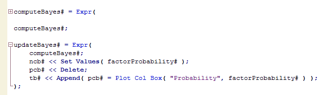

You can add code folding markers that show the beginning and the end of the code block, allowing you to collapse and expand code inside stand-alone functions.
To turn on this feature, select JSL code folding in the Script Editor preferences. Then you can expand and collapse blocks of code by right-clicking on a script and selecting Advanced > Expand All or Collapse All.
Tip: To fold or expand all code in the entire script, press Shift and Ctrl then click a code marker.
After you select this preference, Function and Expr expressions are foldable. See Add More Folding Keywords for more information about adding folding markers to other expressions.
Figure 4.7 Code Folding Markers Shown in a Script
