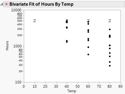

First, use the Bivariate platform to see a plot of hours by temperature using the log scale for time.
3. Select Hours and click Y, Response.
4. Select Temp and click X, Factor.
5. Click OK.
Figure 14.7 Bivariate Plot of Hours by Log Temp

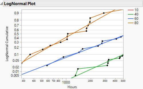

Next, use the survival platform to produce a LogNormal plot of the data for each temperature.
6. Select Analyze > Reliability and Survival > Survival.
7. Select Hours and click Y, Time to Event.
8. Select Censor and click Censor.
9. Select Temp and click Grouping.
10. Select Weight and click Freq.
11. Click OK.
12. Click the red triangle next to Product-Limit Survival Fit and select LogNormal Plot and LogNormal Fit.
13. Click OK.
Figure 14.8 Lognormal Plot

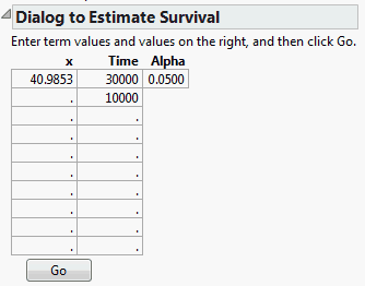

Finally, get estimates of survival probabilities extrapolated to a temperature of 10 degrees Celsius for the times 30000 and 10000 hours.
21. Click the Parametric Survival Fit red triangle and select Estimate Survival Probability.
22. Enter the values shown in Figure 14.10 into the Dialog to Estimate Survival.
The Arrhenius transformation of 10 degrees is 40.9853, the effect value.
Figure 14.10 Estimating Survival Probabilities
23. Click Go.
