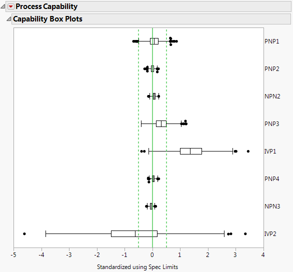

Figure 7.11 shows a Capability Box Plots report for eight variables in the Semiconductor Capability.jmp sample data table.
Figure 7.12 Capability Box Plot
The plot displays dotted green lines drawn at ±0.5.
For a process with a target that is centered between its specification limits, the dotted green lines represent the standardized specification limits.
For a process with a target that is not centered between its specification limits, one of the dotted green lines represents the standardized specification limit for the limit closer to the target. The other dotted green line represents the same distance in the opposite direction.
This plot is useful for comparing variables with respect to their specification limits. For example, in Figure 7.12, the majority of points for IVP1 are above its USL, and the majority of its points for IVP2 are less than its target. PNP2 seems to be on target with all data points in the specification limits.
