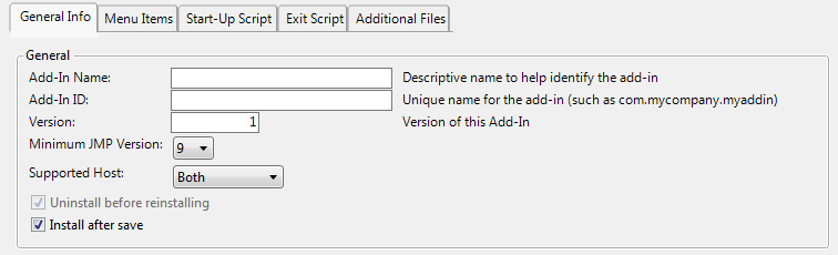

Add General Information
First, in the General Info tab, add the general information that identifies and sets up your add-in.
Figure 16.29 Add-In Builder General Info Tab
1. Enter a name for the add-in.
This is the name of the registered add-in, which appears in the View > Add-Ins window.
2. Enter a unique identifier string.
Unique ID strings are case-insensitive. To ensure uniqueness, it is strongly recommended to use reverse-DNS names (for example, com.mycompany.myaddin). The ID string must meet the following requirements:
It can be up to 64 characters in length.
It must begin with a letter.
It should consist only of letters, numbers, periods, and underscores.
It should contain no spaces.
In JSL, use this string to refer to the add-in (for example, in calls to Get Addin() or as an argument to $ADDIN_HOME).
3. Enter the version of the add-in.
If you decide to make changes to the add-in at a later date, you can update the version number and then verify that users have the correct version.
4. Select the minimum version of JMP that the add-in works on.
Note: Add-ins were introduced in JMP 9, so no prior versions are supported. And when saving an application as an add-in, select 10 or 11 as the JMP minimum version.
5. Select whether you want the add-in to be supported on Windows, macOS, or both.
6. (Optional) Select the check box next to Install after save if you want to install the add-in after saving it.
If you do not select this option, the add-in is not installed once you save it, and it does not appear as a selectable menu item in the Add-Ins menu.
