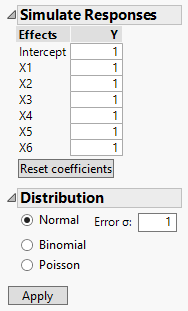

Figure 10.18 Simulate Responses Window
The design table and a Simulate Responses window appear. Two columns are added to the design table:
Y contains a set of values simulated according to the specifications in the Simulate Responses window.
Y Simulated contains a formula that calculates its values using the formula for the model that is specified in the Simulate Responses window. To view the formula, click the plus sign to the right of the column name in the Columns panel.

1. In the Simulate Responses window (Figure 10.18), enter the following values under Y:
Next to Intercept, type 0.
Next to X1, 1 is entered by default. Keep that value.
Next to X2, type 0.9.
Next to X3, type 0.8.
Next to X4, type 0.7.
Next to X5, type 0.6.
Next to X6, type 0.5.
2. In the Distribution outline, select Binomial.
Leave the value for N set to 1, indicating that there is only one unit per trial.
Figure 10.19 Completed Simulate Responses Window
3. Click Apply.

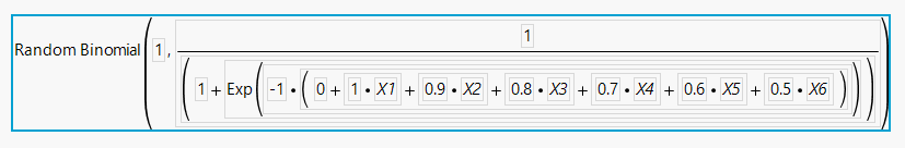

In the design data table, the Y Simulated column is replaced with a formula column that generates binomial values. A column called Y N Trials indicates the number of trials for each run.
4. (Optional) Click the plus sign to the right of Y Simulated in the Columns panel.
Figure 10.20 Random Binomial Formula for Y Simulated

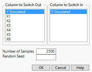

1. In the Effect Tests outline, right-click in the Prob>ChiSq column and select Simulate.
Figure 10.21 Simulate Window
Make sure the Y Simulated column is selected in the Column to Switch Out list. This column contains the values that were used to fit the model. When you select the column Y Simulated under Column to Switch In, for each simulation, you are telling JMP to replace the values in Y Simulated with a new column of values that are simulated using the formula in the column Y Simulated.
The column that you have selected in the report, Prob>ChiSq, is the p-value for a likelihood ratio test of whether the associated main effect is 0. The Prob>ChiSq value is simulated for each effect listed in the Effect Tests table.
2. Next to Number of Samples, type 500.
3. Click OK.

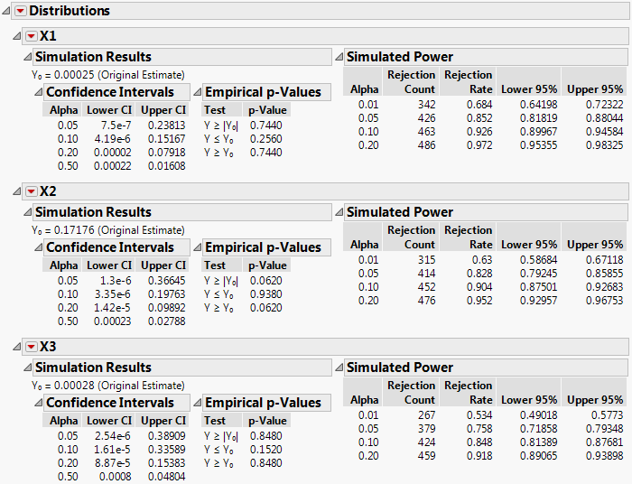

Figure 10.23 Distribution Plots for the First Three Effects
The histograms plot the 500 simulated Prob>ChiSq values for each main effect. The Simulated Power outline shows the simulated Rejection Rate in the 500 simulations.
For easier viewing, stack the reports and de-select the plots, as follows.
5. Click the Distributions red triangle and select Stack.
6. Press Ctrl and click the X1 red triangle, and de-select Outlier Box Plot.
7. Press Ctrl and click the X1 red triangle, select Histogram Options, and de-select Histogram.
Note: Because response values are simulated, your simulated power results might differ from those shown in Figure 10.24.
Figure 10.24 Power Results for the First Three Effects
In the Simulated Power outlines, the Rejection Rate for each row gives the proportion of p-values that are smaller than the corresponding Alpha. For example, for X3, which corresponds to a coefficient value of 0.8 and a probability difference of 38%, the simulated power for a 0.05 significance level is 379/500 = 0.758. Table 10.1 summarizes the estimated power at the 0.05 significance level for all effects. Notice how power decreases as the Difference to Detect decreases. Also notice that the power to detect an effect as large as 24.5% (X6) is only approximately 0.37.
