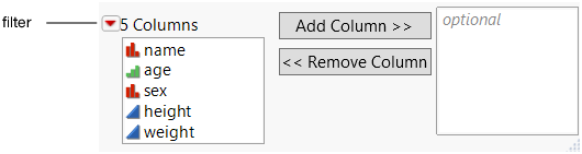

Filter Col Selector
Filter Col Selector() creates a display box that shows a list of items, for example, columns in a data table. The display box is similar to Col List Box() except that Filter Col Selector() enables the user to filter columns by name, modeling type, data type, and so on. And Filter Col Selector() supports transform columns; Col List Box() does not.
Filter Col Selector( <Data Table( name )>, <Width( pixels )>, <Nlines( n )>, <script>, <On Change( expr )>, display box args, ... );
Here’s an example that shows how to use Get Items to display a list of selected columns from the filter col selector.
win = New Window( "Filter Col Selector Example",
	H List Box(
		chooseme =
// filter col selector shows all columns, 100 pixels wide with 6 lines
		Filter Col Selector( width( 100 ), NLines( 6 ) ),
/* line up box arranges button boxes in 1 column
with 2 pixels of space around the boxes */
		Line Up Box( N Col( 1 ), Spacing( 2 ),
					Button Box( "Add Column >>",
/* append the selected column to previously
selected columns */
				listcols << Append( chooseme << Get Selected );
// get a list of selected columns from the filter col selector
					Chosen Columns = listcols << Get Items;
			Button Box( "<< Remove Column",
				listcols << Remove Selected; // remove the selected column
				Chosen Columns = listcols << Get Items; // get the selected column
// create another col list box with no columns inside
			listcols = Col List Box( width( 100 ), NLines( 6 ) ),
Figure 11.10 Filter Col Selector

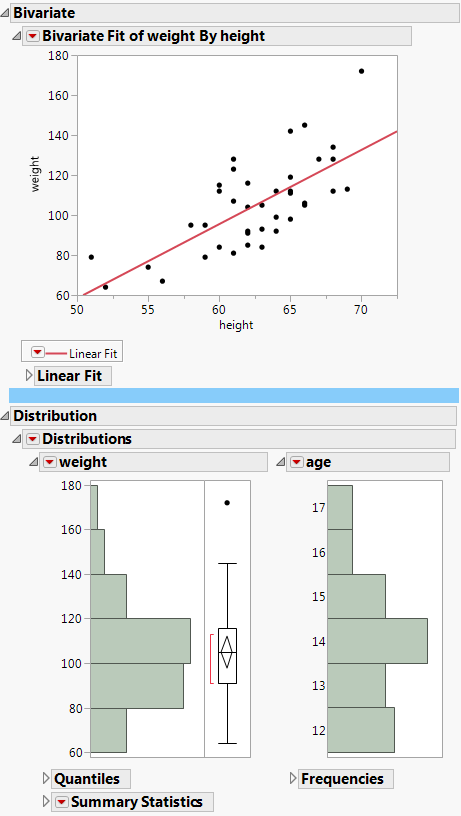

The following example puts a Bivariate and Oneway graph inside an H splitter box. Splitter boxes are especially useful when the content is set to auto-stretching as shown in the example.
win = New Window( "H Splitter Box",
	H Splitter Box(
		Size( 900, 600 ),
		biv = dt << Bivariate( Y( :weight ), X( :height ), Fit Line(), Line Style( Dotted ) ),
		one = Oneway( Y( :height ), X( :sex ), Name( "Means/Anova" )( 1 ), Mean Diamonds( 1 ) )
/* make a reference to the report layers
set the x and y axes on the frame boxes to auto stretch
when the user drags the splitter */
(biv << Report)[FrameBox( 1 )] << Set Auto Stretching( 1, 1 );
(one << Report)[FrameBox( 1 )] << Set Auto Stretching( 1, 1 );

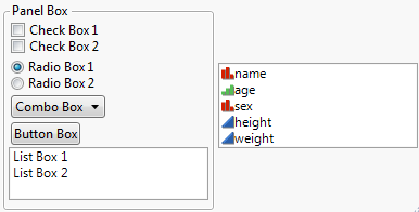

Panel Box
Panel Box() encloses the displaybox argument in a labeled border.
Panel Box( "title", display box args );
In the following example, the panel box appears around the edge of the Distribution launch window:
win = New Window( "Panel Box",
	H List Box( Panel Box( "My Distribution", Distribution() ) )

H Sheet Box and V Sheet Box
Sheet Box() lets you create a grid of plots. H Sheet Box() and V Sheet Box() contain display boxes and arrange them in columns and rows.
H Sheet Box( <<Hold( report ), display box args );
V Sheet Box( <<Hold( report ), display box args );
The general approach is to first consider which display boxes you want and in which arrangement. Create either an H or V Sheet Box and send it a Hold message for each graph to specify which element the sheet box should hold. Finally, create interior H or V Sheet Boxes and tell each one which graph the sheet box should hold.
Here is an example of creating a sheet with four plots: a Bivariate plot, a Distribution, a Treemap, and a Bubble Plot.
First, open the data table and create a new window.
nw = New Window( "Sheet Box Example",
Use a V Sheet Box to organize the window into two columns.
	V Sheet Box(
Send the V Sheet Box() four Hold messages, one for each graph. The order matters.
		<<Hold(
			dt << Bivariate( // graph 1
				Y( :weight ),
				X( :height ),
				Fit Line()
		<<Hold(
			Distribution( // graph 2
				Continuous Distribution(
					Column( :height ),
					Horizontal Layout( 1 ),
					Outlier Box Plot( 0 )
		<<Hold( Treemap( Categories( :age ) ) ), // graph 3
		<<Hold(
			Bubble Plot( // graph 4
				X( :height ),
				Y( :weight ),
				Sizes( :age ),
				Coloring( :sex ),
				Circle Size( 6.226 ),
				All Labels( 0 )
Finally, add two H Sheet Boxes to the V Sheet Box and tell each one which graph it should hold. Each H Sheet Box holds two side-by-side graphs. They are held by a V Sheet Box, so the H Sheet Boxes are displayed vertically.
		H Sheet Box(
			Sheet Part(
Sheet Part displays a previously defined graph, held by Excerpt Box. The first argument is the number of the graph, determined by the order in which you defined the graphs. The first H Sheet Box contains the Bivariate graph on the left and the Distribution on the right. {Picture Box( 1 )} designates which picture box from the report to display. Typically, use 1, the first picture box in the report.
				Excerpt Box( 1, {Picture Box( 1 )} ) // excerpt box 1
			Sheet Part(
				"Distribution of height",
				Excerpt Box( 2, {Picture Box( 1 )} ) // excerpt box 2
		H Sheet Box(
			Sheet Part(
				Excerpt Box( 3, {Picture Box( 1 )} ) // excerpt box 3
			Sheet Part(
				"My Title Here",
				Excerpt Box( 4, {Picture Box( 1 )} ) // excerpt box 4
The Sheet Part() title is required. If you include an empty string as the title, the sheet part’s title is the default report title, for example, “Bivariate Fit of weight By height”.

The following script places a 450 pixel wide and 15 pixel tall blue spacer box between the two outline boxes.
win = New Window( "Spacer Box",
	V List Box(
		Outline Box( "Bivariate",
			biv = dt << Run Script( "Bivariate" ),
			// Color string consists of percentages of RGB values
			Spacer Box( Size( 450, 15 ), Color( {.53, .80, .98} ), )
		Outline Box( "Distribution",
			V List Box( dist = dt << Run Script( "Distribution" ), )
Figure 11.12 Spacer Box Example

Examples of Combined Display Boxes
The following example generates a sample of many controls illustrated in the previous sections.
win = New Window( "Window Controls",
	Line Up Box( N Col( 2 ), Spacing( 3 ),
		Panel Box( "Panel Box",
			Check Box( {"Check Box 1", "Check Box 2"} ),
			Radio Box( {"Radio Box 1", "Radio Box 2"} ),
			Combo Box( {"Combo Box"} ),
			Button Box( "Button Box" ),
			List Box( {"List Box 1", "List Box 2"} )
		Col List Box( "all" )
Figure 11.16 Example of Many Interactive Display Elements

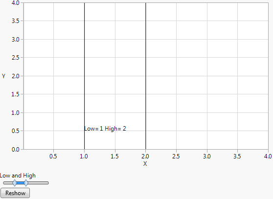

The following script uses a Range Slider Box() instead of a Slider Box() to perform the same function:
lLow = 1;
lHigh = 2;
win = New Window( "Range Slider",
	V List Box(
		gr = Graph Box(
			Frame Size( 500, 300 ),
			X Scale( 0.01, 4 ),
			Y Scale( 0, 4 ),
			XAxis( "Show Major Grid" ),
			YAxis( "Show Major Grid" ),
			X Function( lLow, x );
			X Function( lHigh, x );
			Text( {1, .5}, "Low= ", lLow, " High= ", lHigh );
		V List Box(
			Text Box( "Low and High" ),
			sb = Range Slider Box( 0, 4, lLow, lHigh, gr << Reshow )
	Button Box( "Reshow",
		lLow = 1;
		lHigh = 2;
		gr << Reshow;
		sb << Reshow;
Show( gr );
gr << Reshow;
Figure 11.18 Example of Using Range Slider Box

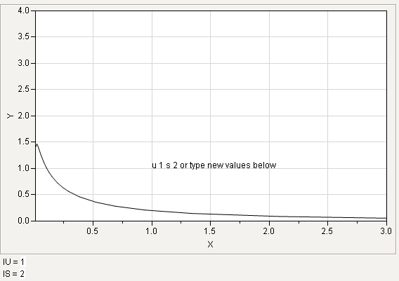

The script below is similar but uses Global Box() as an editable text box instead of two Slider Box() controls:
// Global LogNormal
lU = 1;
lS = 2;
win = New Window( "LogNormal Density",
	V List Box(
		gr = Graph Box( // define the arguments and script for the Graph Box
			X Scale( 0.01, 3 ),
			Y Scale( 0, 4 ),
			Y Function(
				Exp( -(Log( x ) - Log( lU )) ^ 2 / (2 * lS ^ 2) ) / (lS * x *
				Sqrt( 2 * Pi() )),
				x
// display the specified text at 1 on the x and y axes
			Text( {1, 1}, "u= ", lU, " s= ", lS, " or type new values below" );
// display the lU variable value in the first H List Box
		H List Box( Global Box( lU ) ),
// display the lS variable value in the second H List Box
		H List Box( Global Box( lS ) )
Figure 11.19 Example of Using a Global Box Instead of Sliders

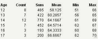

Example of Constructing a Summary Results Report
The following example uses the Summarize() function to collect summary statistics on the Height column of Big Class.jmp and then uses display box constructors to show the results in a nicely formatted window.
Summarize(
	a = by( age ),
	c = count,
	sumHt = Sum( Height ),
	meanHt = Mean( Height ),
	minHt = Min( Height ),
	maxHt = Max( Height )
win = New Window( "Summary Results",
	Table Box(
		String Col Box( "Age", a ),
		Number Col Box( "Count", c ),
		Number Col Box( "Sum", sumHt ),
		Number Col Box( "Mean", meanHt ),
		Number Col Box( "Min", minHt ),
		Number Col Box( "Max", maxHt )
This produces the summary results shown in Figure 11.22.
Figure 11.22 Producing a Customized Summary Report
