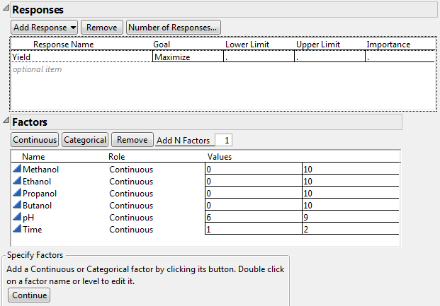

The factors and their settings are given in the data table Extraction Factors.jmp. You create a definitive screening design to investigate.
1. Select DOE > Definitive Screening > Definitive Screening Design.
2. Double-click Y under Response Name and type Yield.
3. Select Help > Sample Data Library and open Design Experiment/Extraction Factors.jmp.
4. Click the red triangle next to Definitive Screening Design and select Load Factors
The factor names and ranges are added to the Factors outline.
Figure 7.2 Responses and Factors for Extraction Design

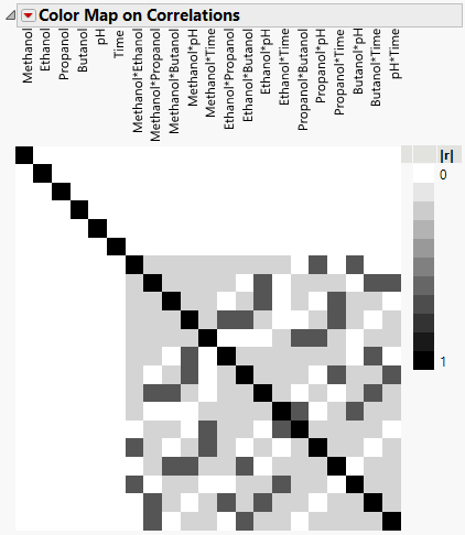

7. Open the Design Evaluation > Color Map on Correlations outline.
The Color Map on Correlations assigns a color intensity scale to the absolute values of correlations among all main effects and two-factor interactions.
Figure 7.4 Color Map on Correlations for Extraction Design
Note the following:
The solid deep blue area shows that there is no correlation between main effects or between main effects and two-factor interactions.
The lighter blue and gray areas indicate that the absolute correlations between two-factor interactions are small.
The solid red squares indicate absolute correlations of 1. These all appear on the diagonal, reflecting the expected correlation of an effect with itself.

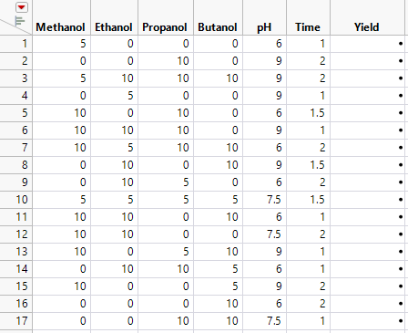

8. Click Make Table to obtain the data table shown in Figure 7.5.
Note: The runs in your design might appear in a different order than the order shown in Figure 7.5.
Figure 7.5 Definitive Screening Design for Extraction Process
