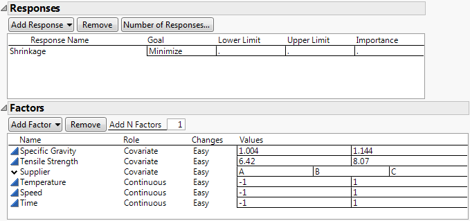

2. Select DOE > Custom Design.
3. Double-click Y under Response Name and type Shrinkage.
4. Click Maximize under Goal and change it to Minimize.
5. Click Add Factor and select Covariate.
6. Select Specific Gravity, Tensile Strength, and Supplier from the list and click OK.
These are covariates and cannot be controlled.
7. Type 3 next to Add N Factors.
8. Click Add Factor > Continuous.
9. Rename the three continuous factors Temperature, Speed, and Time.
These are factors that can be controlled.
Figure 5.62 Responses and Factors Outlines

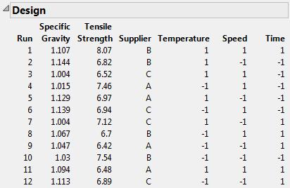

14. Click Make Design.
Figure 5.63 Twelve-Run Optimal Design
This design is D-optimal, given the potential covariate values. It selects the best sets of covariate values and the best settings for the three controllable factors.

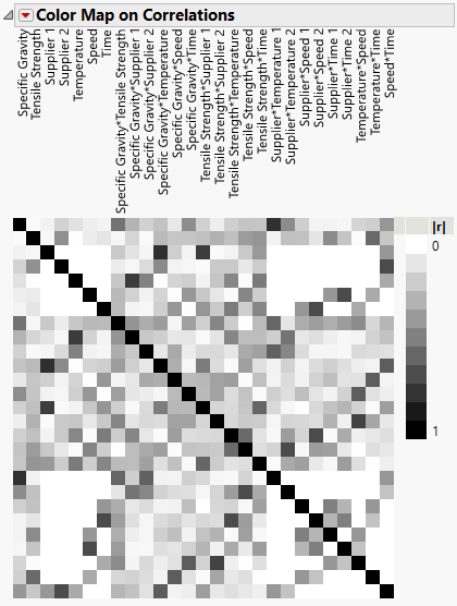

1. Open the Design Evaluation > Color Map On Correlations outline.
Figure 5.64 Color Map on Correlations
The seven terms corresponding to main effects appear in the upper left corner of the color map. Notice that these seven terms are close to orthogonal. The largest absolute correlation is between Tensile Strength and Supplier 2. This absolute correlation of about 0.43 is a consequence of the available covariate values. (Figure 5.64 uses JMP default colors.)
