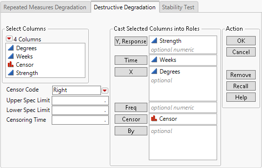

Complete the Launch Window
1. Select Help > Sample Data Library and open Reliability/Adhesive Bond.jmp.
2. Select Analyze > Reliability and Survival > Degradation.
3. Select the Destructive Degradation tab.
4. Select Strength and click Y, Response.
5. Select Weeks and click Time.
6. Select Degrees and click X.
7. Select Censor and click Censor.
Figure 7.18 Completed Launch Window

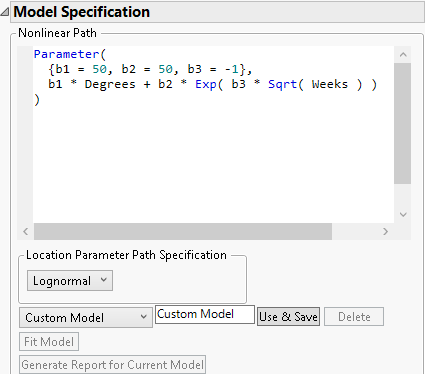

2. Click the Degradation Data Analysis red triangle and select Degradation Path Style > Nonlinear Path.
This adds a script window to the report. You insert a script that specifies your model in this window.
3. Copy the JSL formula below and paste it into the script window under Nonlinear Path:
Parameter(
	{b1 = 50, b2 = 50, b3 = -1},
	b1 * :Degrees + b2 * Exp( b3 * Sqrt( :Weeks ) )
The script defines a model for Strength in terms of parameters b1, b2, and b3. The script specifies initial values for the parameters.
4. In the text box at the bottom of the report, change Empty to Custom Model.
Figure 7.19 Nonlinear Path Script
5. Click Use & Save.

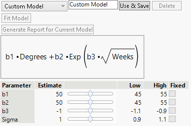

Figure 7.20 Updated Model Specification Outline
The report is updated to include controls for changing initial values for the parameters. Initial values for the parameters are set to the values specified in the formula in the script editor.

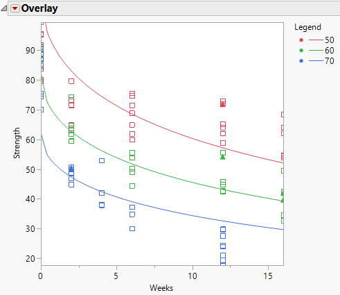

Figure 7.21 Plot of Fitted Model
The Parameter panel in the Model Specification outline is updated to show the parameter estimates for the fitted model. The model fit is shown in the Overlay plot. You can drag the axes to show the points, as is done in Figure 7.21. The legend identifies the curves.

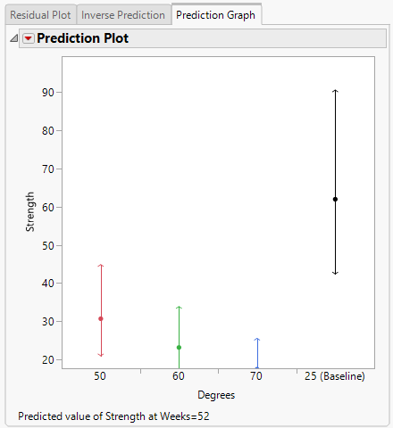

4. Select the Prediction Graph tab in the report.
Figure 7.23 Prediction Plot at Weeks = 52
The Prediction Plot shows the predicted value and its 95% level prediction interval above the axis label of 25 (Baseline).
5. Click the Prediction Plot red triangle and select Save Predictions.
Predicted values for the three values of Degrees and for the desired baseline of 25 degrees are saved to a data table. The predicted strength of the adhesive bond after 1 year at 25o C is 61.96, with a prediction interval of 42.42 to 90.50.
