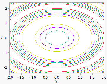

Contour() draws contour lines using a grid of coordinates.
Contour( xVector, yVector, zGridMatrix, zContour, <zColors> );
Suppose that you have an n by m matrix zGridMatrix of values on some surface (defined across the n values of xVector by the m values of yVector). Contour() draws the contour lines that are defined by the values in zContour in the colors defined by zColors. Here is an example:
x = (-10 :: 10) / 5;
y = (-12 :: 12) / 5;
grid = J( 21, 25, 0 );
z = [-.75, -.5, -.25, 0, .25, .5, .75];
zcolor = [3, 4, 5, 6, 7, 8, 9];
For( i = 1, i <= 21, i++,
	For( j = 1, j <= 25, j++,
		grid[i, j] = Sin( (x[i]) ^ 2 + (y[j]) ^ 2 )
Show( grid );
win = New Window( "Hat",
	Graph Box(
		X Scale( -2, 2 ),
		Y Scale( -2.4, 2.4 ),
		Contour( x, y, grid, z, zcolor )
Figure 12.18 Drawing Contour Lines
