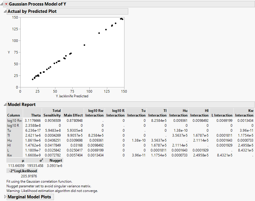

Figure 16.5 Borehole Latin Hypercube ReportĀ
The data on the actual by predicted plot fall along the Y = X line, indicating that the Gaussian process prediction model is a good approximation of the true function. In the Model Report, you see that the first factor, log10 Rw, has the highest total sensitivity. The estimated total sensitivity for log10 Rw explains more than 90% of the variation in the response. Factors with small theta values have little (or no) impact on the prediction formula. Use the profiler to visualize the sensitivities.

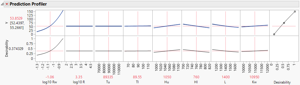

7. Click the Gaussian Process Model of Y red triangle and select Profiler.
Figure 16.6 Gaussian Process Model ProfilerĀ
The desirability function is set to maximize the response Y because Y has goal set to Maximize in the Response Limits column property.
