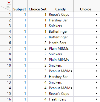

Figure 19.2 Partial Design Table for Candy Preference Survey
The design table contains a Choice column for recording preferences. For each choice set, record a 1 for the most preferred candy, a -1 for the least preferred, and a 0 for the other two candies.

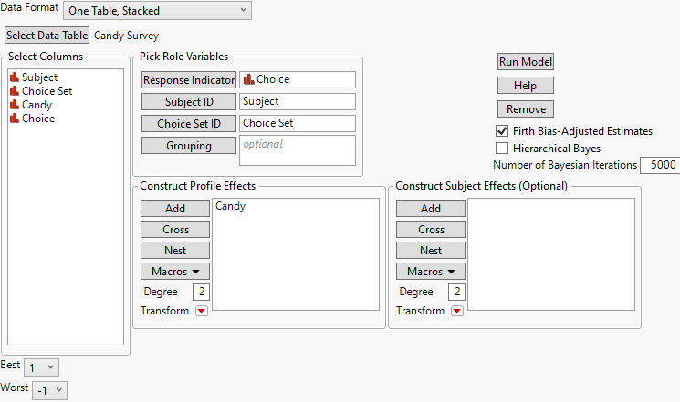

4. Assign roles to columns as follows:
Select Choice and click Response Indicator.
Select Subject and click Subject ID.
Select Choice Set and click Choice Set ID.
Select Candy and click Add in the Construct Profile Effects panel.
Figure 19.3 Completed MaxDiff Analysis Launch Window
Because you designated the Best choice as 1 and the Worst choice as -1, you make no change to the Best and Worst choice indicators at the bottom left of the launch window.

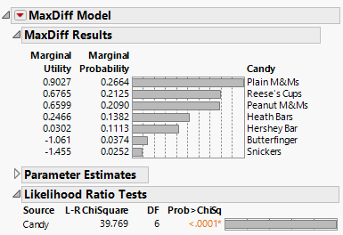

5. Click Run Model.
Figure 19.4 MaxDiff Report
The report indicates that Candy is significant. The three candy types with the highest utilities are Plain M&Ms, Reese’s Cups, and Peanut M&Ms.
