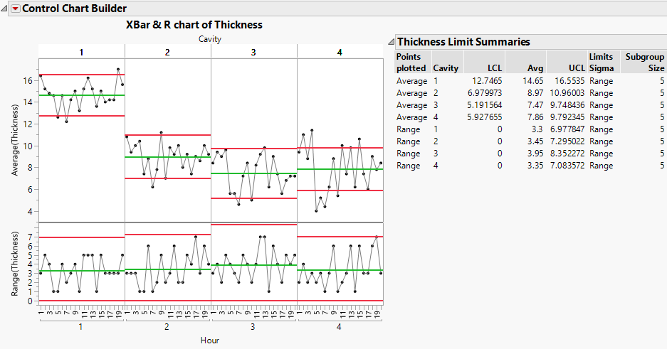

Figure 3.3 Control Charts for Each Cavity
From the Average chart, you can conclude the following:
There are differences between the cavities, indicating the need for separate control limits for each cavity.
Cavity 1 is producing sockets with a higher average thickness, indicating that further investigation of the differences between cavities is warranted.
All of the cavities have points that are outside the control limits. Therefore, you should investigate the lack of control in the data for each cavity.
The Range chart for each cavity shows that the within-subgroup measurements are in control.
