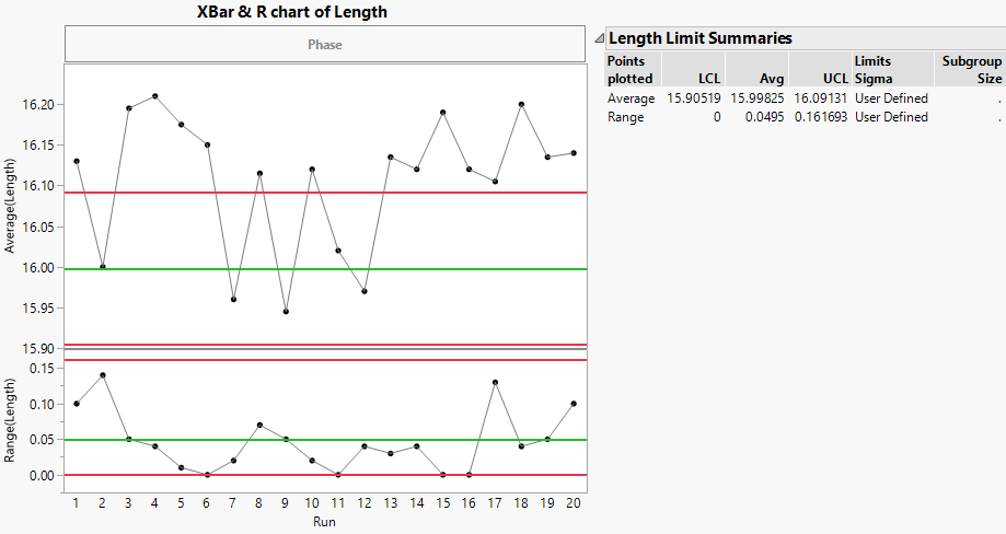

Set Control Limits Option
One simple way to specify control limits is to use the Set Control Limits option in Control Chart Builder.
1. Select Help > Sample Data Library and open Quality Control/New Length Data.jmp.
This is the table that contains your new data.
2. Select Analyze > Quality and Process > Control Chart Builder.
3. Drag Length to the Y zone.
4. Drag Run to the Subgroup zone (at bottom).
5. Right-click in the Average (XBar) chart and select Limits > Set Control Limits.
6. Enter these limits:
LCL - 15.90519
Avg - 15.99825
UCL - 16.09131
These are the historical limits from the Average (XBar) chart in Figure 3.10.
7. Click OK.
8. Right-click in the Range (R) chart and select Limits > Set Control Limits.
9. Enter these limits:
LCL - 0
Avg - 0.0495
UCL - 0.161693
These are the historical limits from the Range (R) chart in Figure 3.10.
10. Click OK.
Figure 3.11 XBar and R Chart of Line Length with Historical Limits
Rather than calculating limits from the data, JMP used the historical control limits that you defined. In the Length Limit Summaries table, notice that the Limits Sigma now says User Defined. Many points now fall outside of the limits. Also, the averages are higher than those of the baseline process. This process is different from the original process that we used to calculate the baseline control limits.

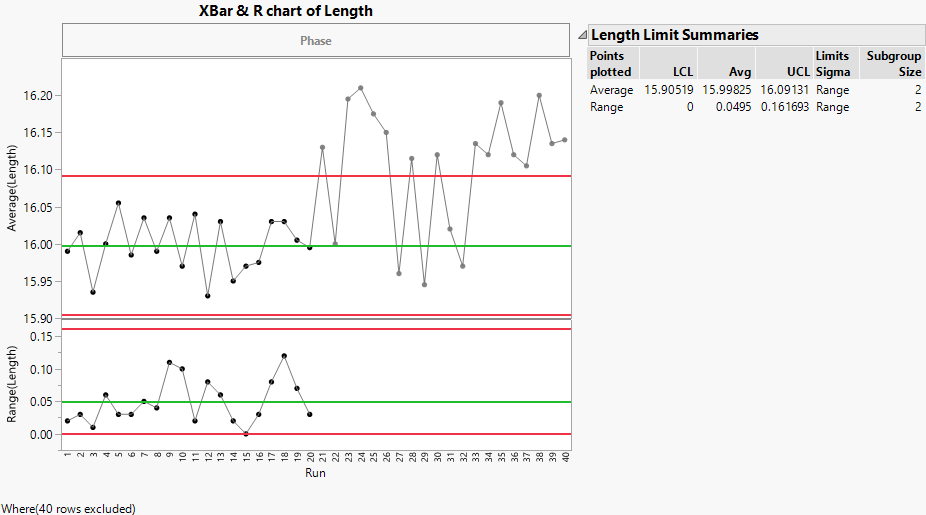

Exclude Rows
Another way to specify control limits is to exclude rows in a data table. One advantage to this method is that you can see both the historical data and new data in the same graph. This can help to determine differences.
To use this method, you must meet the following criteria:
New and old data must reside in the same data table.
Historical data and new data must all have equal subgroup sizes.
All new data must be excluded in the data table (using Rows > Exclude/Unexclude).
In the following example, new data have already been excluded.
1. Select Help > Sample Data Library and open Quality Control/Combined.jmp.
This table contains old and new data, and new data is excluded.
Figure 3.12 XBar and R Chart of Line Length with Excluded Data
JMP uses only the unexcluded rows (historical data) to create the control limits. The new data (excluded data) is still plotted on the graph (dimmed), but these data were not used in any of the calculations.

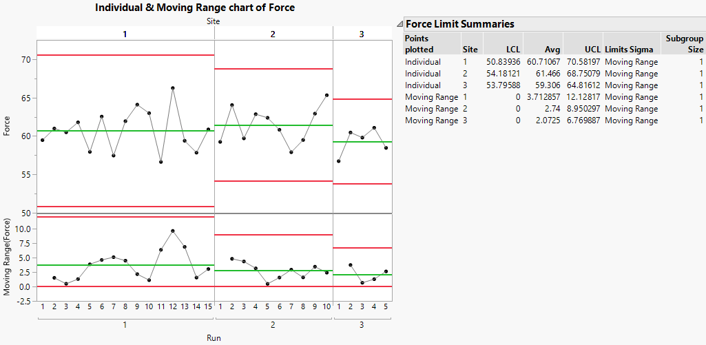

Specify Multiple Sets of Control Limits
In this example, you want to set different control limits for different phases of a process. The column property, set control limits, and excluded row state methods will not work in this situation because these methods are limited to only one set of control limits for the entire chart. For a control chart with phases, you need to use the get limits method.
In the printing company, the goal is to reduce the variability of the force needed to break the bond between paper and the book spine for three different sites. Each site has different machines, different operators, and is also located in different countries; therefore, each site has a unique set of historical limits and information. For all three sites, the company does the following:
1. Creates a baseline control chart based on the existing process data.
2. Changes the process, based upon a designed experiment.
3. Gathers data from the new process.
4. Creates a new control chart based on the new process data.
The goal is to plot the new data on a control chart using historical limits from the old process. This way, the printing company can compare the new process to the old process limits.
Create a Control Chart Based on Existing Process
1. Select Help > Sample Data Library and open Quality Control/Phase Historical Data.jmp.
This table contains the existing process data for all three sites.
3. Drag Force to the Y zone.
5. Drag Site to the Phase zone.
Figure 3.13 Baseline Control Chart for Existing Data
