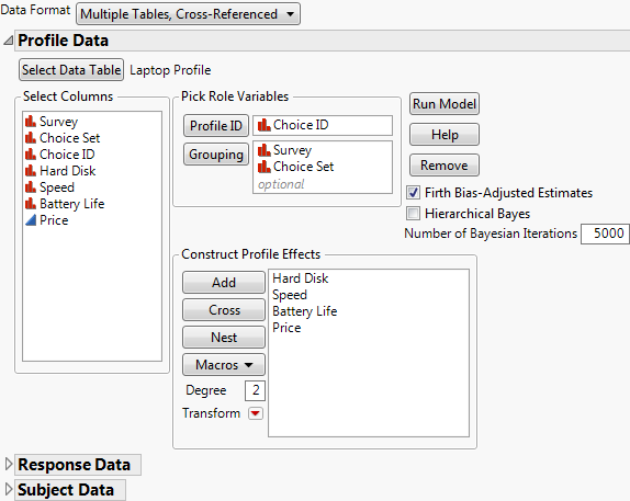

4. From the Data Format list, select Multiple Tables, Cross-Referenced.
5. Click Select Data Table under Profile Data and select Laptop Profile.jmp. Select Choice ID and click Profile ID.
6. Select Hard Disk, Speed, Battery Life, and Price and click Add.
7. Select Survey and Choice Set and click Grouping.
Figure 4.22 Profile Data Window for Laptop Study

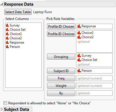

8. Open the Response Data outline.
9. From the Select Data Table list, select Laptop Runs.jmp.
10. Complete the Response Data table as follows:
Select Response and click Profile ID Chosen.
Select Choice1 and Choice2 and click Profile ID Choices.
Select Person and click Subject ID.
Figure 4.23 Response Data Window for Laptop Study

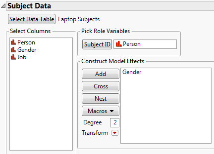

11. Open the Subject Data outline.
12. From the Select Data Table list, select Laptop Subjects.jmp.
13. Select Person and click Subject ID.
14. Select Gender click Add.
Figure 4.24 Subject Data Window for Laptop Study

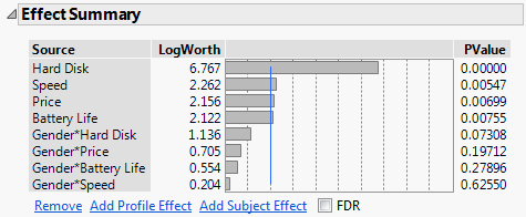

Figure 4.25 Laptop Effect Summary
The Effect Summary report shows that Hard Disk is the most significant effect. You can reduce the model by removing terms with a p-value greater than 0.15. This process should be done one term at a time. Here, Gender*Speed is the least significant effect, with a p-value of 0.625.
2. In the Effect Summary report, select Gender*Speed and click Remove.
Figure 4.26 Laptop Results
Once Gender*Speed is removed from the model, all effects have a p-value of 0.15 or less. Therefore, you use this as your final model.

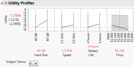

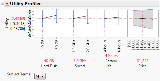

3. Click the Choice Model: Response red triangle and select Utility Profiler.
Figure 4.27 Laptop Profiler Results for Females
Tip: If your utility profiler does not look like Figure 4.27, click the Utility Profiler red triangle and select Appearance > Adapt Y Axis.
4. From the list next to Subject Terms, select M.
Figure 4.28 Laptop Profiler Results for Males in Development
The interaction effect between Gender and Hard Disk is highly significant, with a p-value of 0.0033 (Figure 4.26). In the Utility Profilers, check the slope for Hard Disk for both levels of Gender. You see that the slope is steeper for females than for males.

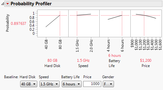

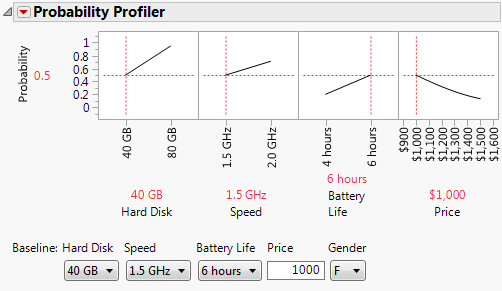

2. Click the Choice Model: Response red triangle and select Probability Profiler.
Note that the Probability Profiler is for Gender = F. You can change this later.
3. Using the menus and text box below the profiler, in the Baseline area, specify the Baseline settings as 40 GB, 1.5 GHz, 6 hours, and 1000.
4. Now set these as the values in the Probability Profiler. To set the Price at $1000, click $1242 above Price under the rightmost profiler cell, and type 1000. Then click outside the text box.
Figure 4.29 Probability Profiler with Text Entry Area for Price
This configuration has probability 0.5.
5. In the Probability Profiler, move the slider for HardDisk to 80 GB.
Notice that, with this change, the probability is relatively insensitive to increases in Price.
6. Click the $1000 label above the Price cell in the profiler, type $1,200, and click outside the text box.
Figure 4.30 Laptop Probability Profiler Results with Baseline Effects
An increase in Hard Disk size from 40 GB to 80 GB and an increase in price to $1200 coincides with an increased probability of preference, from 0.50 to 0.90 for females. Change the Gender effect in the Baseline to M. The probability of preference is 0.71.

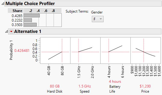

Each factor in each profiler is set to its default values. Alternative 1 indicates the product that you want to develop. Alternative 2 indicates Company A’s product. Alternative 3 indicates Company B’s product.
4. For Alternative 1, set Hard Disk to 40 GB, Speed to 1.5 GHz, Battery Life to 4hours, and Price to $1,000.
5. For Alternative 2, set Hard Disk to 40 GB, Speed to 2.0 GHz, Battery Life to 6 hours, and Price to $1,200.
6. For Alternative 3, set Hard Disk to 80 GB, Speed to 2.0 GHz, Battery Life to 4 hours, and Price to $1,500.

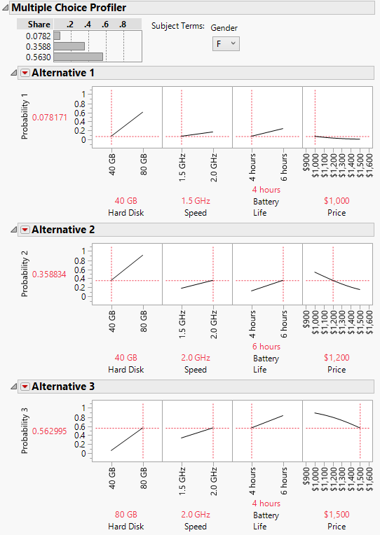

Figure 4.31 Multiple Choice Profiler for Females
You can see that Company B has the greatest Share of 0.5630. It is obvious that with your company’s settings, very few females buy your product.
You want to increase your market share by upgrading your company’s laptop in one of the performance areas while increasing price. The slope of the line in Alternative 1’s Hard Disk profile suggests increasing hard disk space increases market share the most.
7. For Alternative 1, set Hard Disk to 80 GB and Price to $1,200.
Figure 4.32 Multiple Choice Profiler with Improved Laptop
By increasing hard disk space, you can increase the price of your laptop and expect a market share among females of about 43%. This share exceeds that of Company B’s high-performance laptop and is much better than the market share with the initial low-end settings seen in Figure 4.31.
Explore the settings that increase your market share for males. If you increase both Hard Disk size and Speed, you can capture a 44% market share among males.
