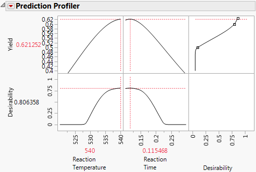

The Prediction Profiler with Desirability Functions enabled appears. For more information about Desirability Functions, see the Desirability Profiling and Optimization in the Profiler section.
5. Click the Prediction Profiler red triangle and select Optimization and Desirability > Maximize Desirability.
The Prediction Profiler maximizes Yield and sets the graphs to the optimum value of Reaction Time and Reaction Temperature.
Figure 8.14 Yield Maximum
The maximum Yield is approximately 0.62 at a Reaction Time of 0.115 hours and Reaction Temperature of 540 degrees Kelvin, or hot and fast. (Your results might differ slightly due to random starting values in the optimization process.)

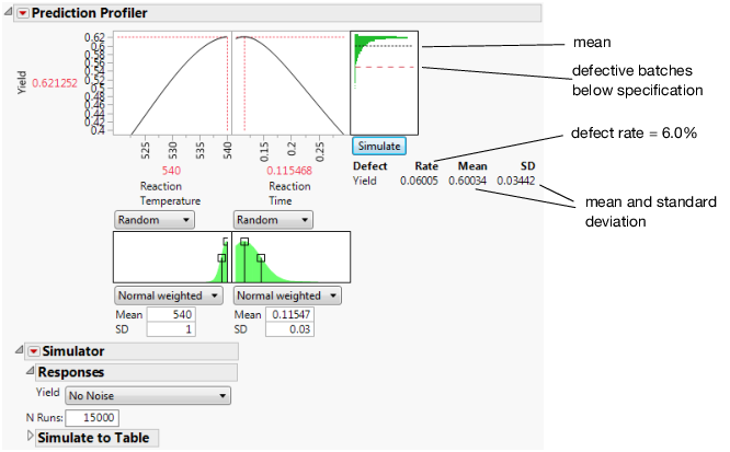

Figure 8.15 Initial Simulator Settings
Yield has a lower spec limit of 0.55, set as a column property, and shows in Figure 8.15 as a dashed red line.
6. Click the Simulate button.
Note: Your numbers might differ from those shown in Figure 8.16 due to the random draws in the simulation.
Figure 8.16 Simulation Results
The predicted Yield is 0.62 for Reaction Temperature of 540 and Reaction Time of 0.115. The simulation estimates an average defect rate of about 6% with a standard deviation of 0.03 given the assumed variation in the temperature and time. The defect rate of 6.0%, indicates that about 6.0% of batches would be out of specification.

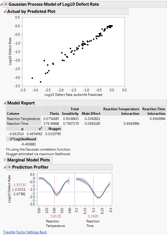

4. From the new data table, click the green triangle next to the Gaussian Process script.
Figure 8.19 Results of Gaussian Process Model Fit
Note: Your results might be slightly different due to the random draws in the simulation.

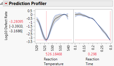

5. To find the settings of Reaction Temperature and Reaction Time that minimizes the defect rate, click the Prediction Profiler red triangle and select Optimization and Desirability > Maximize Desirability.
The desirability function is already set up to minimize the defect rate.
Figure 8.20 Settings for Minimum Defect Rate
The settings that minimize the defect rate are approximately Reaction Temperature = 526 and Reaction Time = 0.3.

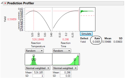

10. With the new settings in place, click the Simulate button to estimate the defect rate at the new settings.
Figure 8.22 Lower Defect Rate
At the new settings the defect rate is 0.05%. This is much lower than the 6.0% for the settings that maximize Yield. That is a reduction of about 120x. Recall that the average Yield from the first settings is 0.62, and the new average is 0.59. The decrease in average Yield of 0.03 is the trade off for lowering the defect rate by 120x.

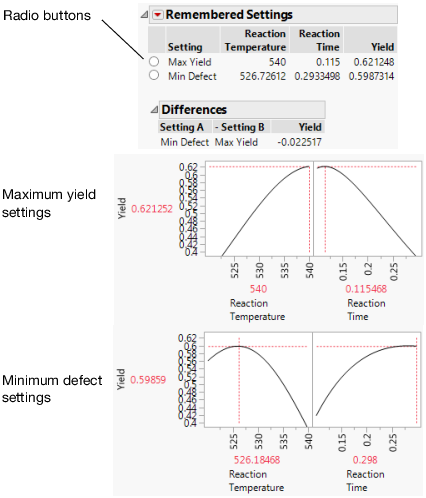

Because you saved the settings using Remember Settings, you can easily compare the old and new settings. The Differences report summarizes the difference.
11. Click the Remembered Settings radio buttons to view the profiler for each setting.
Figure 8.23 Settings Comparison
The chemist now knows what settings to use for a quality process. If the factors have no variation, the settings for maximum Yield are hot and fast. But, if the process inputs have variation similar to what we have simulated, the settings for maximum Yield produce a high defect rate. Therefore, to minimize the defect rate in the presence of factor variation, the settings should be cool and slow.
