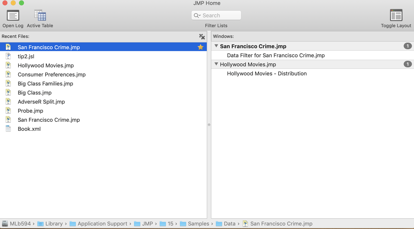

JMP Home Window on macOS
Use the JMP Home window on the macOS to quickly access JMP files and open windows.
Open recent files in the Recent Files list.
Press Control and select a file in the Recent Files list to perform common tasks, such as adding or removing a favorite.
Open or close active JMP windows in the Windows list.
Set an open data table as the current data table by selecting it from the Active Table list. Press the Option key while selecting the data table from the list to activate the data table without bringing it to the front.
Open the log.
Find a file in the Recent Files list or an open window in the Windows list by entering a search term in the Search box.
Click Toggle Layout to display the Recent Files and Windows lists horizontally instead of vertically.
Open the JMP Home window on macOS by selecting Window > JMP Home (Figure 2.15). To view the window each time you open JMP, select JMP > Preferences > General > Home Window.
Figure 2.15 Example of the JMP Home Window (macOS)
Tips:
The Status bar area shows the path for the currently selected file. You can click a folder to open the folder to view its contents.
To be able to quickly view the JMP Home window from any JMP window, press Control and click the window, select Customize Toolbar, and drag the JMP Home icon to the toolbar.
To copy a file from Recent Files to another document or into the Finder, select the file and then select Edit > Copy.
