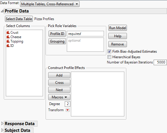

Figure 4.13 Launch Window for Multiple Tables, Cross-Referenced Data Format
Figure 4.13 shows the launch window for Multiple Tables, using Pizza Profiles.jmp as the Profile table.
In the case of Multiple Tables, Cross-referenced, the launch window has three sections:
Profile Data
Response Data
Subject Data

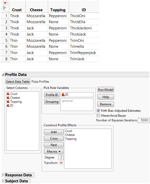

Profile Data
The profile data table describes the attributes associated with each choice. Each attribute defines a column in the data table. There is a row for each profile. A column in the table contains a unique identifier for each profile. Figure 4.14 shows the Pizza Profiles.jmp data table and a completed Profile Data panel.
Figure 4.14 Profile Data Table and Completed Profile Data Outline

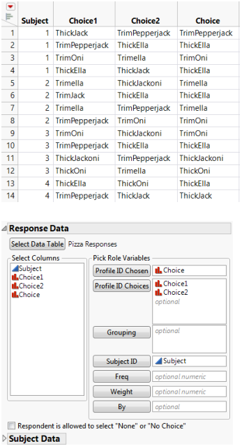

Response Data
The response data table includes a subject identifier column, columns that list the profile identifiers for the profiles in each choice set, and a column containing the preferred profile identifier. There is a row for each subject and choice set. Grouping variables can be used to distinguish choice sets when the data contain more than one group of choice sets. Figure 4.15 shows the Pizza Responses.jmp data table and a completed Response Data panel.
Grouping variables can be used to align choice indices when more than one group is contained within the data.
Figure 4.15 Response Data Table and Completed Responses Data Outline

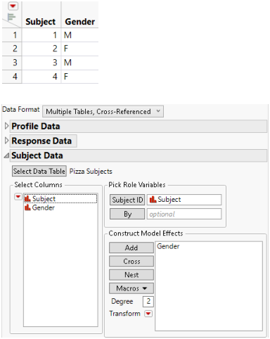

Subject Data
The subject data table is optional and depends on whether you want to model subject effects. The table contains a column with the subject identifier used in the response table, and columns for attributes or characteristics of the subjects. You can put subject data in the response data table, but you should specify the subject effects in the Subject Data outline. Figure 4.16 shows the Pizza Subjects.jmp data table and a completed Subject Data panel.
Figure 4.16 Subject Data Table and Completed Subject Data Outline
