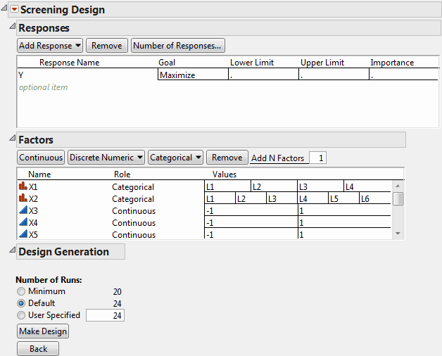

In the following experimental situation, no standard design exists. You need a design to study 13 factors: 2 are categorical, one with 4 levels and one with 6 levels, and 11 are continuous.
1. Select DOE > Classical > Two Level Screening > Screening Design.
In the Responses panel, there is a single default response called Y. Keep this as the default response.
2. In the Factors panel, click Categorical and select 4 Level.
This adds the variable X1 with levels L1 through L4.
3. Click Categorical and select 6 Level.
This adds the variable X2, with levels L1 through L6.
4. Enter 11 next to Add N Factors.
5. Click Continuous.
This adds 11 factors, X3 to X13, each at two levels, -1 and 1.
6. Click Continue.
The Design Generation panel appears.
There is no option to select a design from the Design List since there are no available standard designs in this situation.
Keep the default number of runs, which is 24.
Figure 9.9 Screening Design Window for 13-Factor Design with Design Generation PanelĀ
7. Click Make Design.
A Design and a Design Evaluation outline appear.
8. Open the Design outline to see the randomized design.

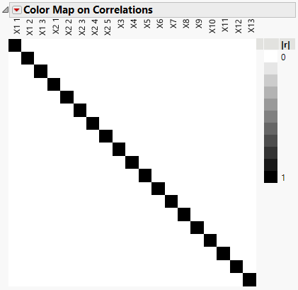

Next, examine the Color Map on Correlations to see that this specific design is orthogonal.
9. Open the Design Evaluation > Color Map on Correlations outline.
The color map (Figure 9.10) shows black entries (using JMP default colors) on the main diagonal, indicating correlations of one. This is because each diagonal cell corresponds to the correlation of a term with itself, which is one. Off-diagonal correlations are all white, indicating that correlations between distinct terms are zero. Hold your mouse pointer over any cell to see the relevant terms and their absolute correlation.
