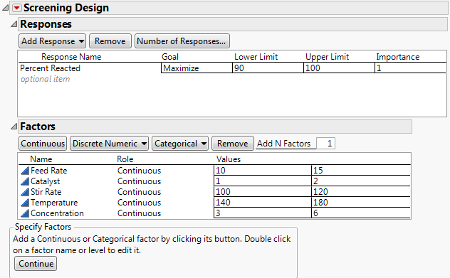

1. Select DOE > Classical > Two Level Screening > Screening Design.
2. Double-click Y under Response Name and type Percent Reacted.
Note that the default Goal is Maximize. The Goal is to maximize the response, but the minimum acceptable reaction percentage is 90 (Lower Limit) and the upper limit is 100 (Upper Limit).
3. Click under Lower Limit and type 90.
4. Click under Upper Limit and type 100.
5. Leave the area under Importance blank.
Because there is only one response, that response is given Importance 1 by default.
See Figure 9.19 for the completed Responses outline. Now, specify the factors.

1. Add five continuous factors by entering 5 in the Add N Factors box and clicking Continuous.
2. Change the default factor names (X1-X5) to Feed Rate, Catalyst, Stir Rate, Temperature, and Concentration.
3. Enter the low and high values, as follows:
Feed Rate: 10, 15
Catalyst: 1, 2
Stir Rate: 100, 120
Temperature: 140, 180
Concentration: 3, 6
Figure 9.19 Responses and Factors Outlines

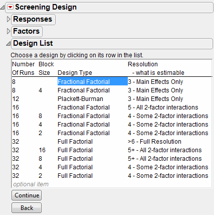

2. From the Choose Screening Type panel, accept the default selection to Choose from a list of fractional factorial designs and click Continue.
Designs for the factors and levels that you specified are listed in the Design List (Figure 9.20).
Figure 9.20 Fractional Factorial Designs for Five Continuous Factors
3. The design that you want is the first in the list and happens to be selected by default (Figure 9.20). Accept that selection and click Continue.
Because you are limited to eight runs and have no blocking factor, your best design option is the 8-run fractional factorial design with no blocks. This design is a 25-2 fractional factorial design. It is one quarter of the full factorial design for five factors.

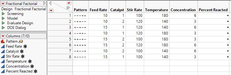

5. In the Output Options outline, accept the default Run Order setting of Randomize and click Make Table.
Figure 9.24 Eight-Run Fractional Factorial Design Table
The design table shows the design that you constructed. Notice that the table contains a column for the response that you defined in the Screening window, Percent Reacted, where you can record your experimental results.
The Screening, Model, and DOE Dialog scripts are also included. For more information about these scripts, see Make Table.

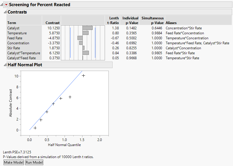

1. Select Help > Sample Data Library and open Design Experiment/Reactor 8 Runs.jmp.
You can estimate seven effects with your eight runs. Of these, you expect only a few to be active. Because you want to estimate seven effects, there are no degrees of freedom for error. For these reasons, you use the Screening platform to analyze the results.
2. Run the Screening script in the data table.
The Screening script launches the Screening platform (DOE > Classical > Two Level Screening > Fit Two Level Screening) for your response and factors.
Figure 9.25 Report for Screening Example
Note: Since the p-values are obtained using a simulation-based technique, your p-values might not precisely match those shown here.
The report shows both Individual and Simultaneous p-values based on Lenth t-ratios. None of the effects are significant, even with respect to the Individual p-values. The Half Normal Plot suggests that the effects reflect only random noise.
For more information about the Screening report, see The Screening Report in the The Fit Two Level Screening Platform section.
