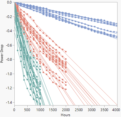

The initial overlay plot of the data appears.
Figure 7.7 Device B Overlay Plot

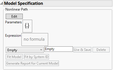

The degradation paths appear linear for the first several hundred hours, but then start to curve. To fit a nonlinear model, select Degradation Path Style > Nonlinear Path from the Degradation Data Analysis red triangle menu to show the Nonlinear Path Model Specification outline (Figure 7.8).
Note: To view the Edit button displayed in Figure 7.8, you must select the interactive formula editor preference (File > Preferences > Platforms > Degradation > Use Interactive Formula Editor) before launching the Degradation platform.
Figure 7.8 Initial Nonlinear Model Specification Outline
The first step to create a model is to select one of the options on the menu initially labeled Empty:

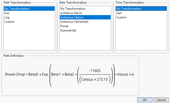

Constant Rate Models
The Constant Rate option is for modeling degradation paths that are linear with respect to time (or linear with respect to time after transforming the response or time). The reaction rate is a function of temperature only.
Select Constant Rate from the menu shown in Figure 7.8. The Constant Rate Model Settings window prompts you to enter transformations for the Path, Rate, and Time.
Figure 7.9 Constant Rate Transformation
Once a selection is made for each transformation, the associated formula appears in the lower left corner as shown in Figure 7.9.
After all selections are made, click OK to return to the report. For more information about all the features for Model Specification, see Model Specification Details.
