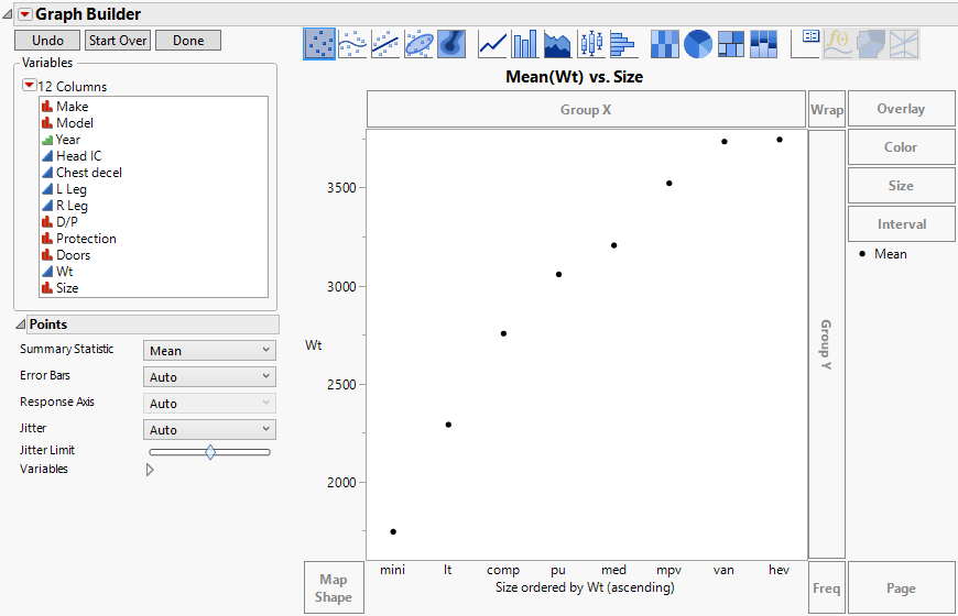

4. Select Wt and drag it to the middle of the X axis. Drop it just above the X axis. Before you drop the variable, a blue quadrilateral appears.
Figure 3.19 Merging Wt and Size
The levels of Size are now arranged in increasing order according to the average Wt of all vehicles in the levels. Notice that mini and lt (lightweight) are now ordered before hev (heavy). The axis label is updated, signifying that an ordering variable is in use.
Next, verify that Size is actually ordered by Wt.
5. Select Wt and drag it to the Y zone.
6. Select Mean from the Summary Statistic list.
Figure 3.20 Example of Size Ordered by Wt, Ascending
You can see that the average Wt increases from left to right.

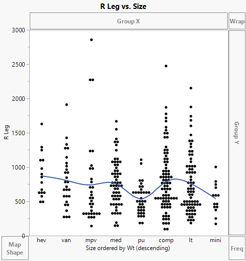

Change the order from ascending to descending.
7. Right-click in the X zone and select Order By > Wt, descending.
Now the levels of Size are arranged in decreasing order of mean Wt. You want to see whether the right femur load (R Leg) decreases with vehicle weight.
8. Right-click Wt in the Y zone and select Remove.
9. Select R Leg and drag it to the Y zone.
10. Select None from the Summary Statistic list.
This selection replaces the means with points for all the individual observations.
11. Click the Smoother element .
Figure 3.21 Example of R Leg Ordered by Wt, Descending
R Leg seems unrelated to the weight classes.
