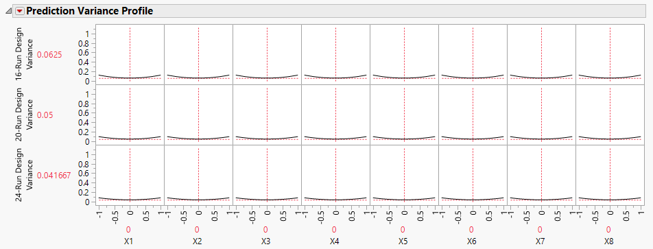

The Prediction Variance Profile outline shows profilers of the relative variance of prediction for each design being compared. Each plot shows the relative variance of prediction as a function of each factor at fixed values of the other factors.
To find the maximum value of the relative prediction variance over the design space for the reference design, select the Maximize Variance option from the red triangle next to Prediction Variance Profile. See Maximize Variance.
Figure 16.23 Prediction Variance Profile for Three Designs
The Prediction Variance Profile plot in Figure 16.23 is for the three designs constructed in Designs of Different Run Sizes. Two two-way interactions, X1*X3 and X2*X3, have been added to the Model outline. The initial value for each continuous factor in the plot is the midpoint of its design settings. The Variance values to the left indicate that, as the number of runs increases, the variance decreases at the center point.

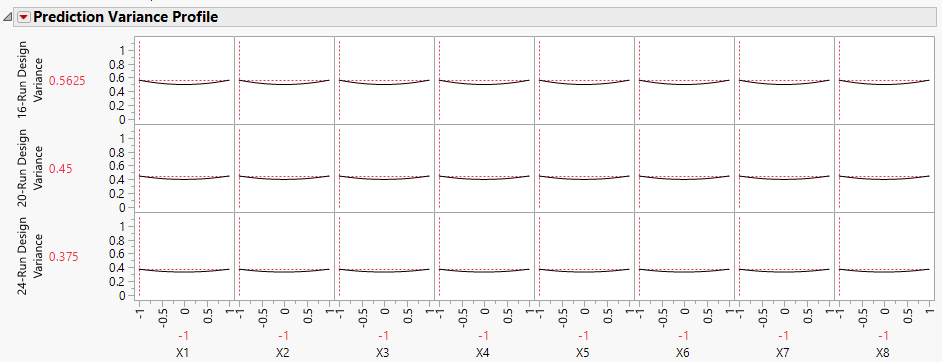

You can also evaluate a design or compare designs in terms of the maximum relative prediction variance. Select the Maximize Variance option from the red triangle next to Prediction Variance Profile. JMP uses a desirability function that maximizes the relative prediction variance. The value of the Variance in the Prediction Variance Profile is the worst (least desirable from a design point of view) value of the relative prediction variance.
Figure 16.24 Prediction Variance Profile Showing Maximum Variance for Three Designs
Figure 16.24 shows the Prediction Variance Profile after Maximize Variance was selected for the three designs constructed in Designs of Different Run Sizes. As expected, the maximum relative prediction variance decreases as the run size increases. The plot also shows values of the factors that give this worst-case relative variance. However, keep in mind that many settings can lead to this same maximum relative variance.
