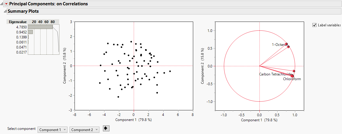

The initial Principal Components report is for an analysis on Correlations. It summarizes the variation of the specified Y variables with principal components (Figure 4.4). You can switch to an analysis based on the covariance matrix or unscaled data by selecting the Principal Components option from the red triangle menu.

The details in the report show how the principal components absorb the variation in the data. The principal component points are derived from the eigenvector linear combination of the variables.
Figure 4.4 Principal Components on Correlations Report
The report gives the eigenvalues and a bar chart of the percent of the variation accounted for by each principal component. There is a Score Plot and a Loadings Plot as well. The eigenvalues indicate the total number of components extracted based on the amount of variance contributed by each component.
The Score Plot graphs each component’s calculated values in relation to the other, adjusting each value for the mean and standard deviation.
The Loadings Plot graphs the unrotated loading matrix between the variables and the components. The closer the value is to 1, the greater the effect of the component on the variable.
By default, the report shows the Score Plot and the Loadings Plot for the first two principal components. Use the list next to Select component to specify the principal components that are graphed on the Score Plot and the Loadings Plot.
