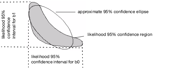

Figure 14.20 shows the contour of the goal SSE or negative likelihood, with the least squares (or least loss) solution inside the shaded region:
The asymptotic standard errors produce confidence intervals that approximate the region with an ellipsoid and take the parameter values at the extremes (at the horizontal and vertical tangents).
Profile confidence limits find the parameter values at the extremes of the true region, rather than the approximating ellipsoid.
Figure 14.20 Diagram of Confidence Limits for Parameters
