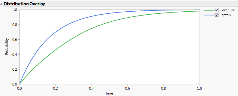

The Show Design Comparisons option displays a Distribution Overlay plot and a Remaining Life Distribution Overlay plot. These plots appear in the Workspace below the System Diagram. See Figure 11.14 and Figure 11.15.
The Distribution Overlay plot shows the probability of system failure for each of the designs in the Designs panel.

Figure 11.14 Distribution Overlay Example
