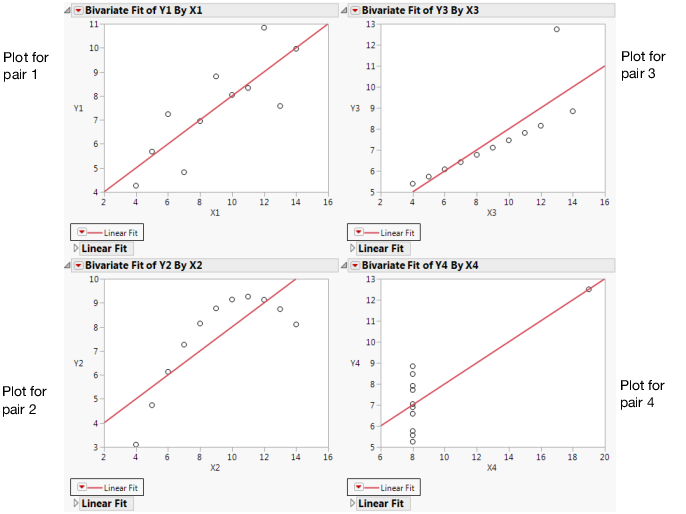

Figure 5.3 Scatterplots with Points Added
The scatterplots show that the relationship between X and Y is not the same for the four pairs, although the lines describing the relationships are the same:
Plot 1 represents a linear relationship.
Plot 2 represents a non-linear relationship.
Plot 3 represents a linear relationship, except for one outlier.
Plot 4 has all the data at x = 8, except for one point.
This example illustrates that conclusions that are based on statistics alone can be inadequate. A visual exploration of the data should be an early part of any data analysis.
