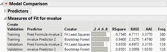

Figure 10.7 shows an example of the initial Model Comparison report for a continuous response.
Figure 10.7 Initial Model Comparison Report
The Predictors report shows all responses and all models being compared for each response. The fitting platform that created the predictor column is also listed.
The Measures of Fit report shows measures of fit for each model. The columns are different for continuous and categorical responses.
