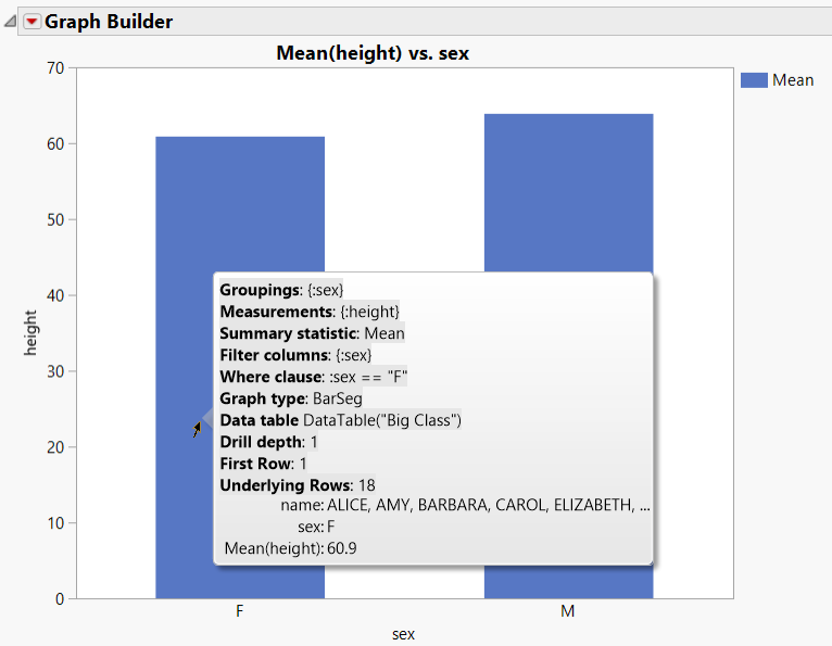

Complete Example of the Hover Label Execution Context Variables
The following script produces the graph shown in Figure 12.50. When you place your pointer over a bar, the hover label appears. Details about the data and the Hover Label Context Execution variables appear in the log.
dt << Graph Builder(
	Size( 528, 450 ),
	Show Control Panel( 0 ),
	Variables( X( :sex ), Y( :height ) ),
	Elements( Bar( X, Y, Legend( 3 ) ) ),
	SendToReport(
		Dispatch(
			"Graph Builder",
			FrameBox,
			{Set Textlet(
				Setup(
					local:encodedWhere = XML Encode( local:_where );
					/* Show() provides additional information about the
					HLEC variables in the log */
					Show( Namespace( "local" ) << Get Contents() );
				Markup(
<b>Groupings</b>: {local:_groupings}
<b>Measurements</b>: {local:_measurements}
<b>Summary statistic</b>: {local:_summaryStatistic}
<b>Filter columns</b>: {local:_filters}
<b>Where clause</b>: {local:encodedWhere}
<b>Graph type</b>: {local:_displaySegName}
<b>Data table</b> {local:_dataTable}
<b>Drill depth</b>: {local:_drillDepth}
<b>First Row</b>: {local:_firstRow}
<b>Underlying Rows</b>: {local:_underlyingRows}
Figure 12.50 Bar Chart with Textlet
