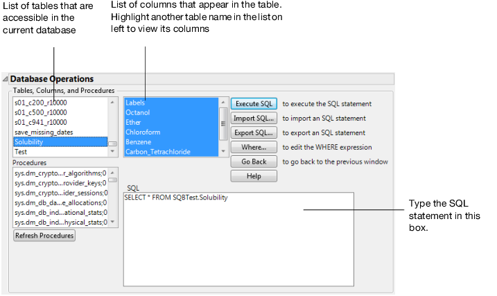

3. From the Database Open Table window, click the Advanced button to open specific subsets of a table.
4. Either type in a valid SQL statement, or modify the default statement. Figure 3.67 shows a default SQL Select statement appropriate for the selected file. See Structured Query Language (SQL): A Reference, for a description of SQL statements that you can use.
Instead, you can add expressions by clicking the Where button and using the WHERE Clause editor to create expressions. See Use the WHERE Clause Editor.
Figure 3.67 Reading All Variables from the Solubility Table Stored in an Excel File
