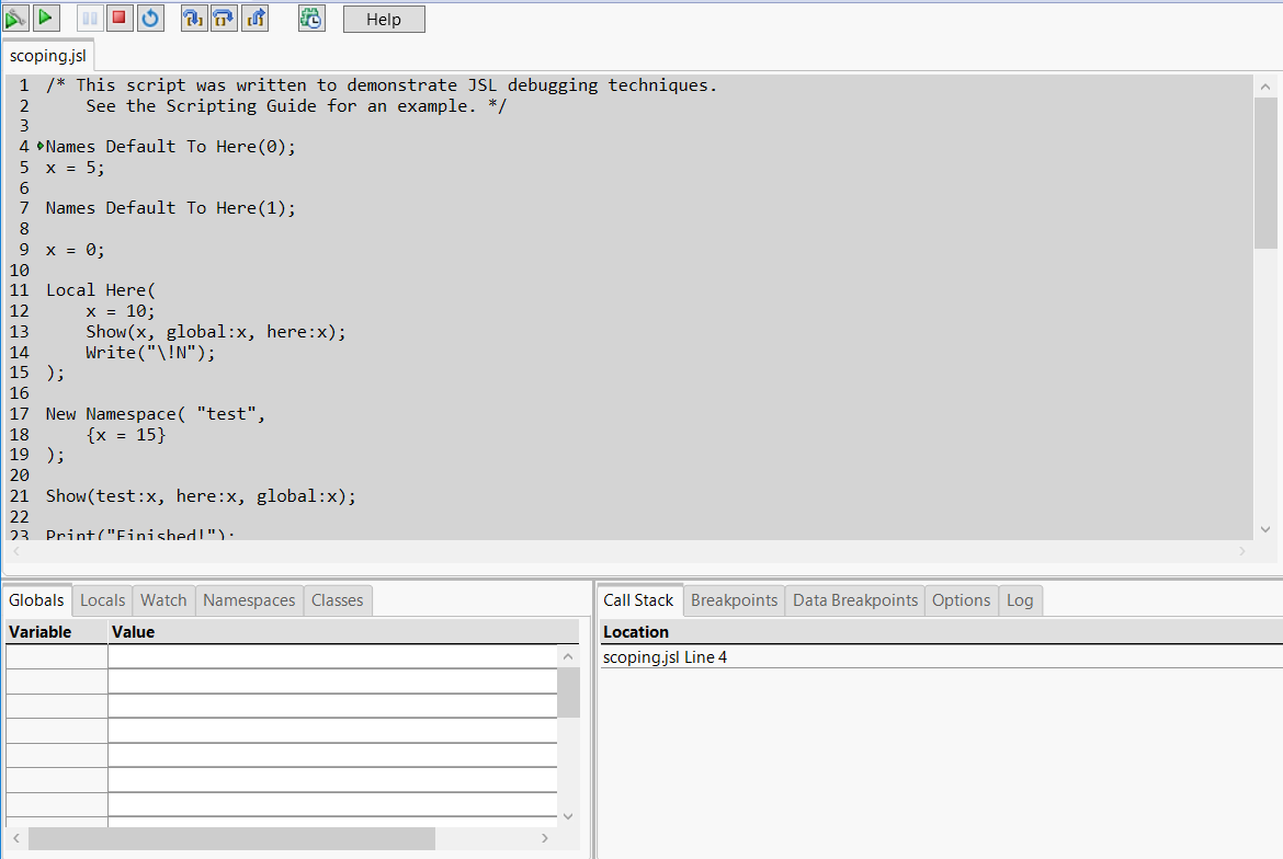

The Debugger opens in a new instance of JMP (Figure 4.10). The original instance is inoperable until the script produces something that requires interaction. At that point, the Debugger window becomes inoperable until you perform whatever action is required. Then control is returned to the Debugger. Close the Debugger to work again in the original instance of JMP.
Figure 4.10 The Debugger Window
Use the buttons at the top to control the Debugger or the JSL Profiler. One or more scripts that you are debugging or profiling are shown in tabs. If your script includes other scripts, each one opens in a new tab.
Tabs in the bottom portion of the Debugger provide options to view variables, namespaces, the log, and the current execution point; work with breakpoints; and set options.
Tip: To view or edit long values on a tab in the Debugger, right-click the value and select Edit. The code opens in a script editor.

Variable Lists
The tabs on the bottom left of the Debugger let you examine global variables, local variables, watch variables, and variables within namespaces.
Globals
The Globals tab lists all global variables and updates their values as you step through the script. Each variable is added as it is initialized. If there are already global variables defined from running earlier scripts, they will be listed with their current values when you start the Debugger. See View Variables.
Locals
The Locals tab lists all variables by scope and updates their values as you step through the script. Select a scope in the menu. See View Variables.
Watch
If there is a particular variable or value of an expression whose values you want to watch as you step through the code, you can add them here. This is particularly useful if your script uses many variables that might be hard to watch in the Globals or Locals lists. See Work with Watches.
Namespaces
As namespaces are defined, they are added to the menu. Select a namespace to view any variables and their values used within the namespace. See View Variables.
Classes
The Classes tab lists classes that are defined in the script. See Classes in the Programming Methods.
Debugger Options
The tabs on the bottom right of the Debugger let you view the call stack, work with breakpoints, set options, and view the log.
Call Stack
The call stack lists the current execution point in scripts and functions. The main script is always the first script listed. If you call a function, the function is added on top of the calling script. Likewise, any included files are added to the top of the list as you step through them. When you exit any function or script, it is removed from the list and you return to the next one in the list. The current line numbers are updated as you step through.
Double-click a row in the call stack to move the cursor to the specified line.
Breakpoints
Add, edit, delete, and disable or enable breakpoints on lines. See Work with Breakpoints. You can also double-click a row on the Breakpoints tab to move the cursor to the specified line.
Data Breakpoints
Add, edit, delete, and disable or enable breakpoints in variables. Data breakpoints watch for changes in variables, unlike breakpoints, which watch for changes in lines.
Options
Set the Debugger preferences interactively on this tab. See Modify Preferences in Debugger.
Log
The log from the script that you are debugging is shown on this tab.
