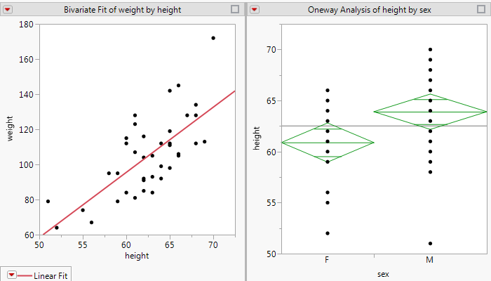

This example shows how to write a script that creates a dashboard with two reports in a row:
New Window( "My Dashboard",
H Splitter Box( // place reports in a splitter box
Size( 700, 400 ),
Tab Page Box( // place report in a tab page box
Title( "Bivariate Fit of weight by height" ),
dt << Bivariate( // Bivariate report
Y( :weight ),
X( :height ),
Fit Line,
Report View( "Summary" ) // show only the graph
<<Moveable( 1 ) // make the report moveable
Tab Page Box(
Title( "Oneway Analysis of height by sex" ),
dt << Oneway( // Oneway report
Y( :height ),
X( :sex ),
Means( 1 ),
Mean Diamonds( 1 ),
<<Moveable( 1 )
/* each tab box can be dragged to a different location
required for moveable display boxes */
<<Dockable( 1 )
Figure 11.27 Dashboard with Two Reports

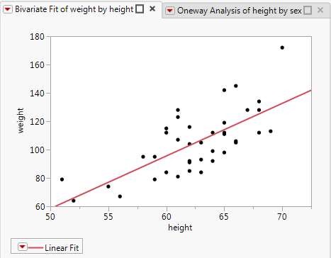

The following script creates a dashboard that places each report on a tab:
Tab Box( // place reports in a tab box
Title( "Bivariate Fit of weight by height" ),dt << Bivariate( // Bivariate report
Y( :weight ),
X( :height ),
Fit Line,
<<Moveable( 1 ), // make the report moveable
<<Closeable( 1 ) // make the report closeable
Tab Page Box( Title( "Oneway Analysis of height by sex" ),dt << Oneway( // Oneway report
Y( :height ),
X( :sex ),
Means( 1 ), Mean Diamonds( 1 ), Report View( "Summary" )),
<<Moveable( 1 ),
<<Closeable( 1 )
<<Dockable( 1 ),
<<Set Overflow Enabled( 0 ) // both tab pages appear
Figure 11.28 Dashboard with Tabs

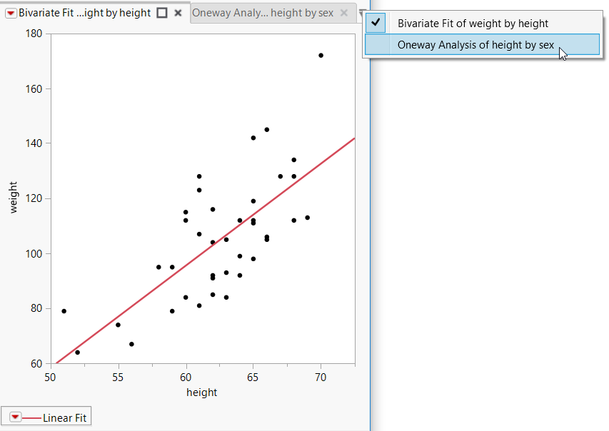

In a dashboard with several tabs, the window widens to show all tabbed reports. You might want to show only the first report and then let the user select the other tabbed reports from a list. Change Set Overflow Enabled( 0 ) near the end of the script to Set Overflow Enabled( 1 ). Figure 11.29 shows the result.
Figure 11.29 Dashboard with Overflow Tabs

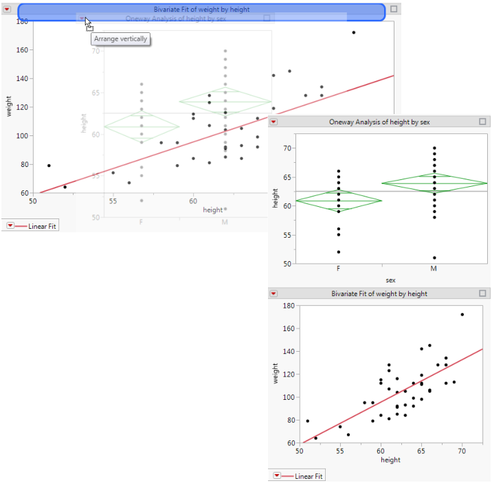

A docking layout is a collection of Tab Page Box() objects and docking containers that enable reports to be rearranged. In the report window, you drag a docked tab to a highlighted drop zone to create a new layout. Figure 11.27 shows two docked reports. In Figure 11.30, the Oneway report was dragged to the highlighted drop zone to display the reports in one column.
Figure 11.30 Docking a Tab in a Dashboard

In the report window, you reposition tab pages by clicking the tab title and dragging the tab page to a highlighted drop zone. The highlighted drop zones indicate how to arrange reports horizontally, vertically, or in tabs. If a valid drop zone is not selected, the box returns to its original location.

When a docking layout includes tab page boxes, you may place many pages in a single Tab Box() container. In this case, the titles may become wider than the actual content or wider than desired in the overall display. The Tab Box <<Set Overflow Enabled( 0|1 ) message specifies that the tab titles should not cause the tab box to grow wider. If the titles do not all fit, a pop-up button appears in the upper right corner of the tab box to select tabs that are in the “overflow list”. See Figure 11.29 for an example.
