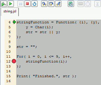

2. Click in the margin for line 12 to add a breakpoint.
You should have a breakpoint for the following expression inside the For() loop:
stringFunction(i);
Figure 4.11 Set the Breakpoint
3. Click Run.

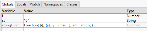

4. Click Run again.
The script runs until it hits the breakpoint. The results are shown in Figure 4.13.
– stringFunction() is called, evaluated, and returns to the loop.
– i is incremented and determined to be less than or equal to 9.
– In the Globals list, i is now 1 and str is now “0”.
Figure 4.13 Global Variables at First Breakpoint

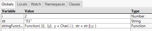

5. Click Run again.
The script runs until it hits a breakpoint. The results are shown in Figure 4.14.
In the Globals list, i is now 2, and str is now “01”.
Figure 4.14 Global Variables at Second Breakpoint

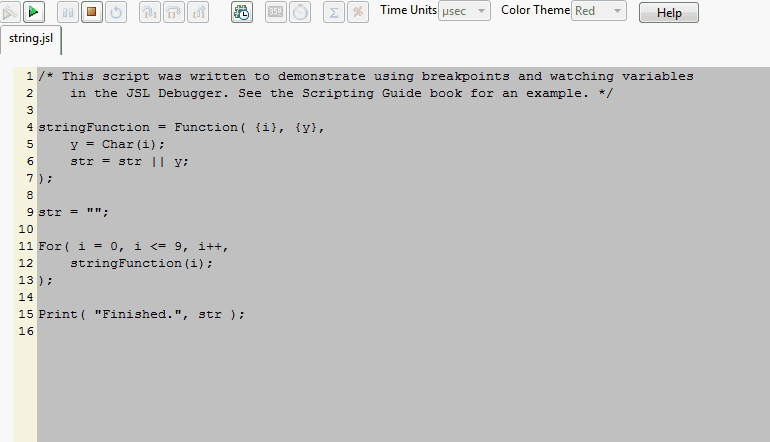

1. Open the string.jsl sample script.
2. Click the Debug Script button .
3. Click the Profile JSL Script button .
Figure 4.15 Initial JSL Profiler Window
4. Click the Run button to start profiling.

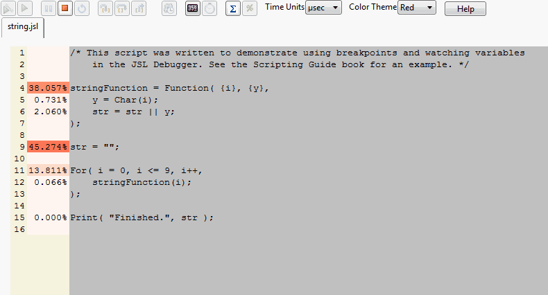

The profiler collects information on the number of times a statement is executed and the time it takes to execute it. Time is cumulative and collected each time a JSL statement is executed.
Figure 4.16 Profiled Script Window
In the left margin, the selected statistics are displayed. Percent of time is displayed by default. Click the Show Profile by Count button to switch to percent of statement counts instead. The left margin is color-coded to allow for quick identification of problematic performance areas.
