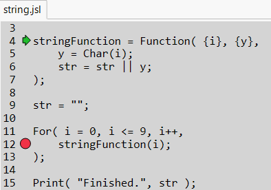

2. Click in the margin for line 12 to add a breakpoint.
You should have a breakpoint for the following expression inside the For() loop:
stringFunction(i);
Figure 4.12 Set the Breakpoint
Set the Breakpoint

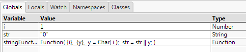

– In the Globals list, i is now 1 and str is now “0”.

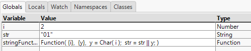

In the Globals list, i is now 2, and str is now “01”.
Figure 4.15 Global Variables at Second Breakpoint

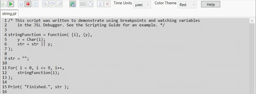

Figure 4.16 Initial JSL Profiler Window
4. Click the Run button Image shown here to start profiling.

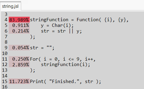

The profiler collects information about the number of times a statement is executed and the time it takes to execute it. Time is cumulative and collected each time a JSL statement is executed.
Figure 4.17 Profiled Script Window
In the left margin, the selected statistics are displayed. Percent of time is displayed by default. Click the Show Profile by Count button Image shown here to switch to percent of statement counts instead. The left margin is color-coded to allow for quick identification of problematic performance areas.
