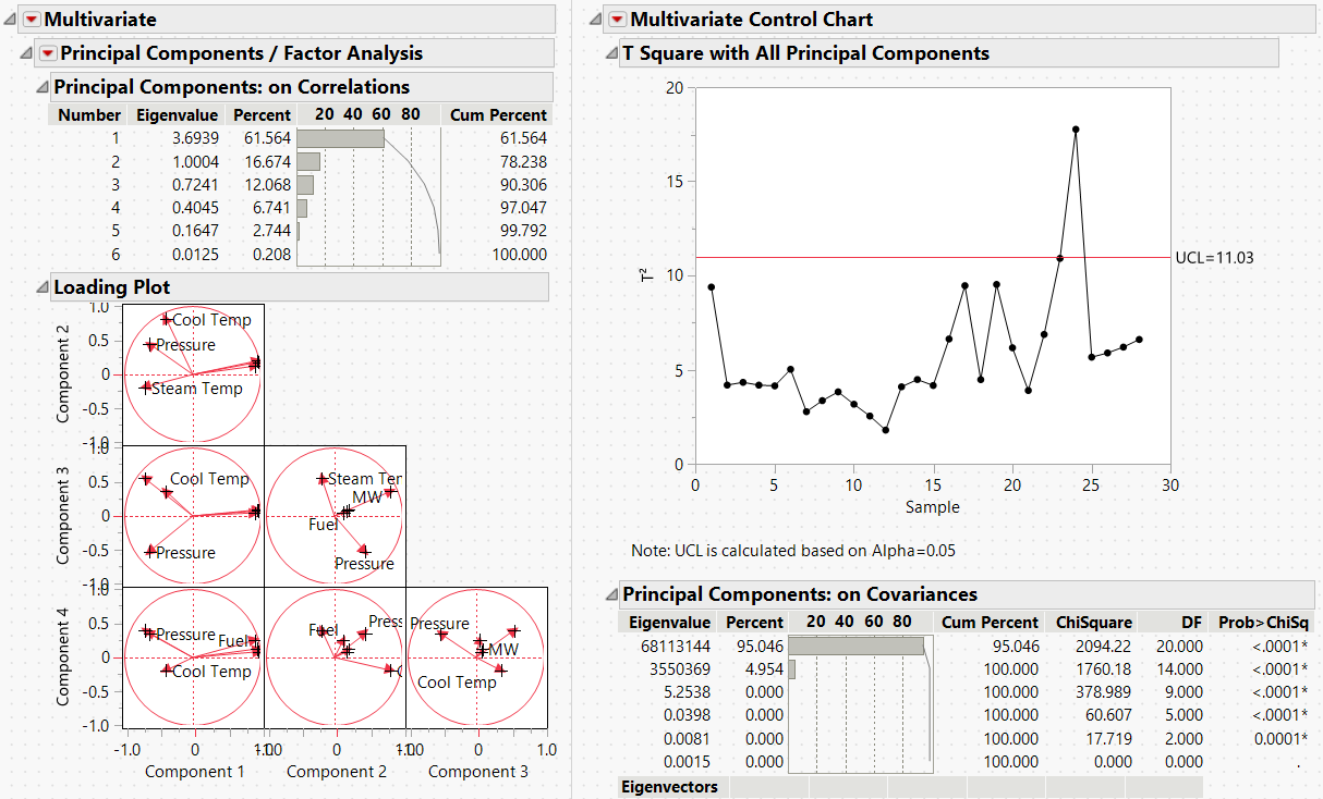

9. Select each report and type yvar next to Y Variable in the Objects panel.
10. Click the Application red triangle and select Run Application.
11. Select the Fuel, Steam Flow, Steam Temp, and MW variables and then click the Y button.
12. Click OK.
New Multivariate reports appear in one window.
Figure 16.12 Multivariate Application

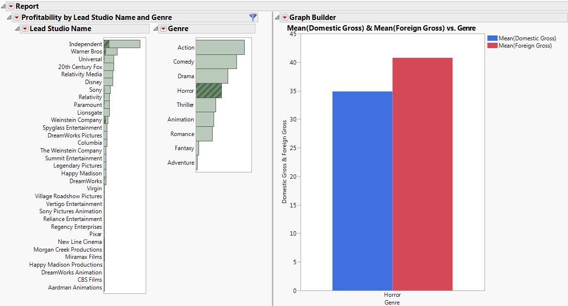

3. Right-click the primary report and select Use as Selection Filter.
This places the primary report display box in a Data Filter Source Box and the parent report display box in a Data Filter Content Box.
4. Click the Application Builder red triangle and select Run Application.
The reports appear in one window (图 16.13).
5. Test the application by selecting a histogram bar in the primary report.
Only data for the selected bar appears in the second report.
Figure 16.13 Example of Filtered Content

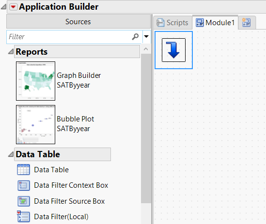

4. Select File > New > Application and choose Blank Application.
5. Double-click Data Filter Context Box.

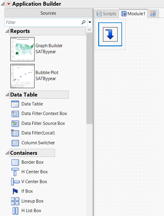

This adds a data filter context box to the workspace. Everything placed in this box will share the same Local Data Filter.
Figure 16.14 Adding a Data Filter Context Box
6. Under Containers, drag a H List Box into the Data Filter Context Box.
This allows you to put multiple objects in this box and arrange them horizontally.
Figure 16.15 Adding a H List Box
Adding a H List Box

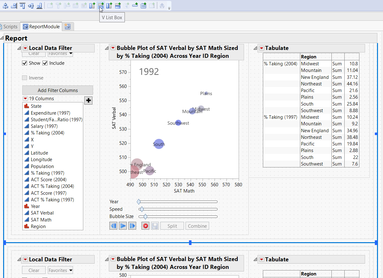

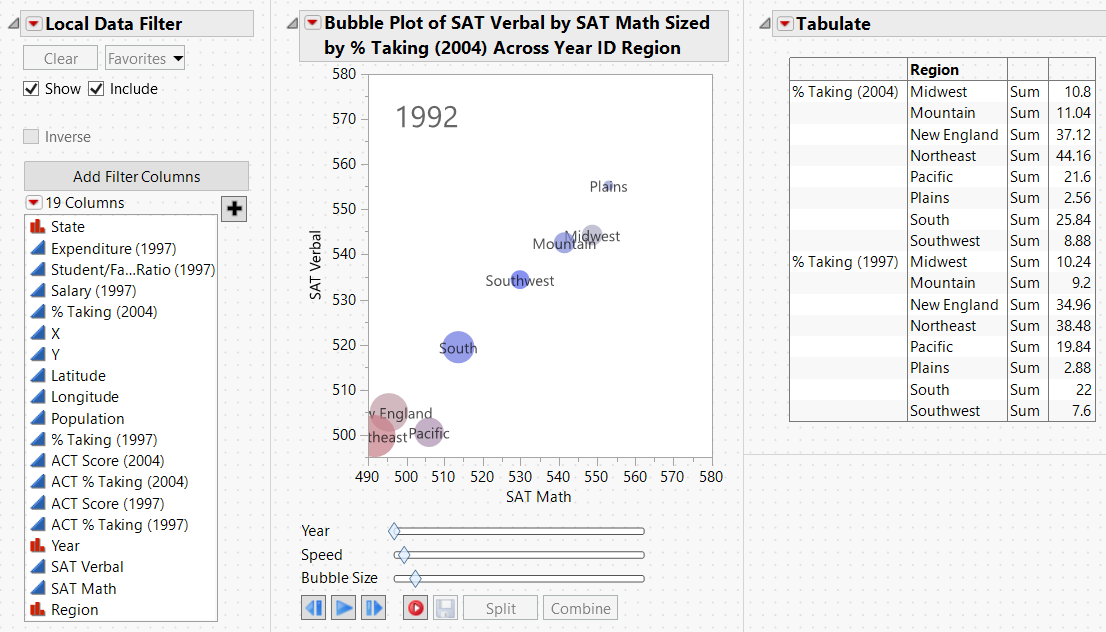

7. Now drag a Data Filter (local), the Bubble Plot, and the Tabulate report into the H List Box.
Figure 16.16 Adding Local Data Filter and Two Reports
8. Select the entire Data Filter Context Box. Press Ctrl and drag it below itself, to place a copy below the original set of reports.
9. Select both Data Filter Context boxes, then on the toolbar, click the V List Box icon.
This arranges both reports into a single list box for display purposes.
Figure 16.17 Selecting Both Data Filter Context Boxes and the V List Box Icon
10. Click the Application Builder red triangle and select Run Application.
11. In the Local Data Filter on the top, click SAT Math, then click the Add button Image shown here. Move the slider to see how it only impacts the reports at top. Do the same for the bottom set of reports.

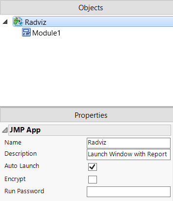

1. In the Objects panel of the blank application, select Application.
2. In the Properties panel:
– Change the Name from Application to “Radviz” and press Enter.
This name appears in the title bar when you run the application.
– Change the Description to “Launch Window with Report”.
Figure 16.19 Customizing the Application

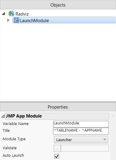

5. In the Objects panel, select Module1.
6. In the Properties panel:
– Change the Variable Name to “LaunchModule” and press Enter.
– Change the Module Type to Launcher.
– Make sure that Auto Launch is selected so that the launch window opens when you run the application.
Figure 16.20 Customizing the LaunchModule

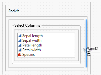

1. Drag a Panel Box (under Containers) to the right of the existing Panel Box until a blue line appears.
Figure 16.22 Adding the Panel Box
Note: Make sure that you drag the Panel Box to the H List Box shown in 图 16.22.

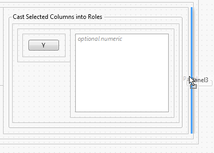

2. In the Properties panel, change the Title to Cast Selected Columns into Roles and press Enter.
3. Drag an H List Box (under Containers) over the Panel Box arrow.

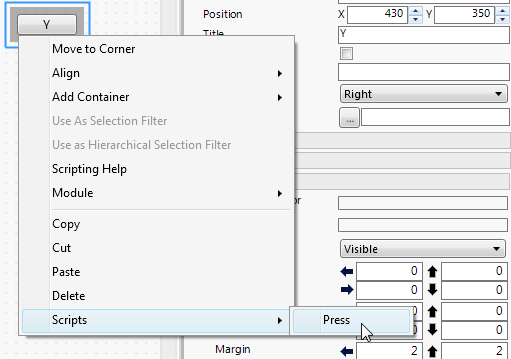

– In the Press box, type “SetY” and press Enter.
You copy and paste the script for this button later.

10. Right-click and select Move to Corner.
The extra space around the selected object is removed.

Create the Report Module Script
1. Go back to the Launcher with Report sample application window.
2. Make sure that the Scripts tab is displayed.
3. Select ReportModule as the Namespace and copy the script.
4. Go back to your application window and click the Scripts tab.
5. Delete the script in the ReportModule namespace and paste the script from the sample application.
6. Select File > Save to save your changes in the.jmpappsource file.
Your application should look like the Launcher with Report sample application.

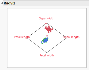

Test and Save the Final Application
1. In your application window, click the Application Builder red triangle and select Run Application.
2. Select the Sepal length and width and Petal length and width columns, click Y, and then click OK.
A graph of the data should appear.
Figure 16.26 Iris.jmp Graph
Iris.jmp Graph

Figure 16.27 Adding a Script Interactively
Selecting a script from the Scripts menu adds a placeholder script to the Scripts tab for the selected module. For example, the Press script shown in 图 16.27 adds the following script to the Scripts tab:
Button5Press=Function({this},
	// This function is called when the button is pressed
	name = this << Get Button Name;
Fill in the placeholder script with your own JSL. In the application that you previously created, you named two variables SetY and ColumnList. Rewrite the preceding placeholder script:
