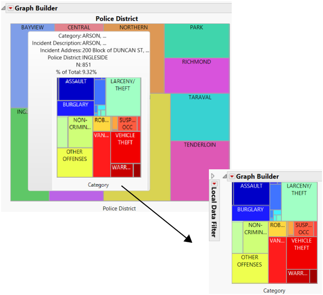

A drill-down graph is created when you click on the thumbnail in a hover label. Clicking on the hover graph opens it in a new window, enabling you to see the graph in more detail and also make modifications such as changing the data filter. For example, click a cell on a treemap to see details about the data in a new window (图 12.48). Press Ctrl and click to replace the contents of the last launched window instead of opening a new window.

图 12.48 shows drilling-down on a cell in a treemap.
Figure 12.48 Example of a Drill-Down Graph on a Hover Label
The following script creates the simplified versions of the treemap presets shown in 图 12.48.
