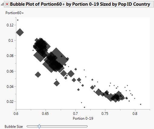

The following example creates the bubble plot and diamond shape shown in 图 12.8:
dt = Open( "$SAMPLE_DATA/PopAgeGroup.jmp" );
bp = dt << Bubble Plot(
	X( :"Portion 0-19"n ),
	Y( :"Portion60+"n),
	Sizes( :Pop ),
	ID( :Country )
bp << Set Shape( "Diamond" );
Figure 12.8 Diamond Shapes
Diamond Shapes
